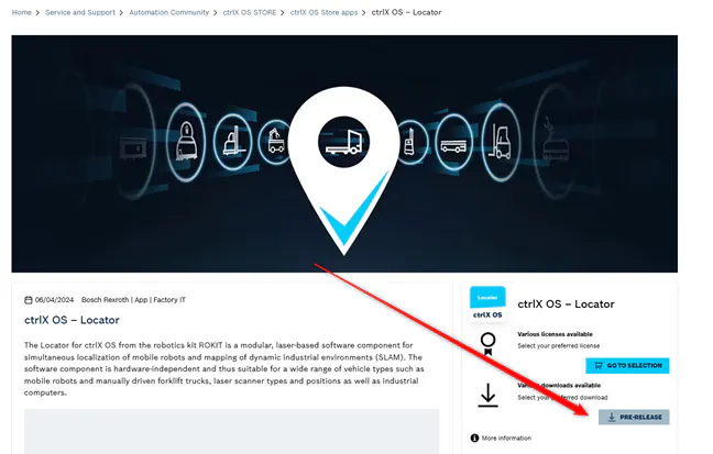

You will find them either under the ctrlX OS apps or under this link.Register here for pre-release for Locator and here for Navigator.
