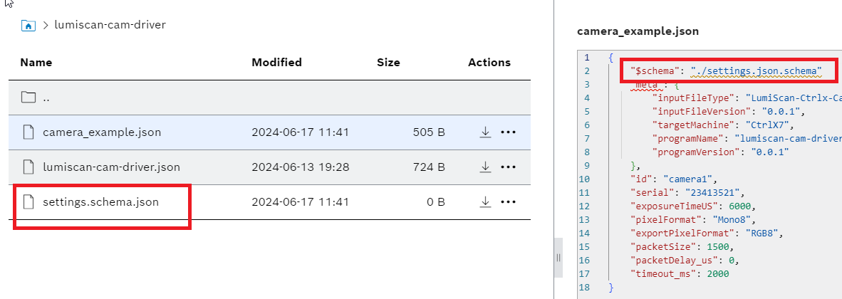

If it is possible to to set $schema using the addresses under "types" in datalayer?
I tried to add "$schema": "setting.schema.json" doens't work, since it is interpreted as inmemory://model/settings.schema.json

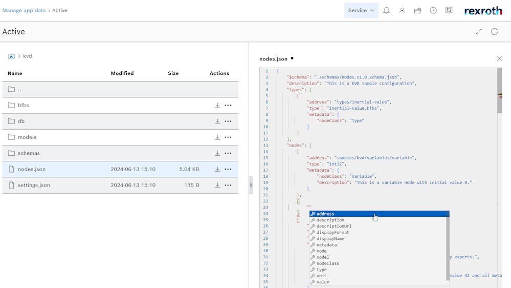

Hi Chih-Peng
I just tested it with our ctrlX Key Value Database app (which also has json files and schemas in the active configuration). And its possible to use auto-completion. See my screenshot:
press CTRL-SPACE while editing
The schema in this case is located in the folder "schema". I tested it with Version 2.6.
Nick
