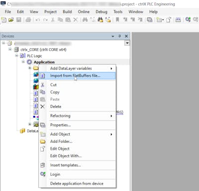

In the current version 2.02 of the ctrlX PLC Engineering you can find an import button to automatically create function blocks for acessing your self created fltbuffer.
ctrlX PLC Engineering - import from flatbuffer file
