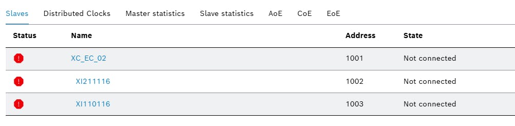

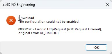

  1. The download from ctrl I/O Engineering to ctrlX CORE could not be completed.
  2. EtherCAT could not be connected to each I/O device.

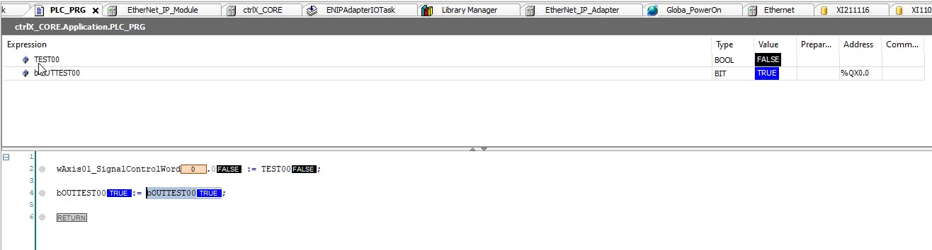

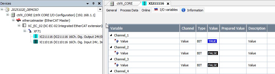

  3. However, the output signal successfully turned ON.
    PLC side

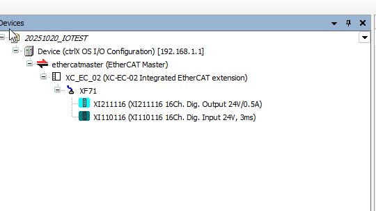

ctrlI/O

Best reply by TheCodeCaptain
Hi Kirikiman
seems like you mixed app versions.
Please make sure every app and your engineering is on the same LTS release, in your case 3.6.x
