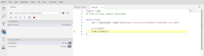

In my case, I am using the Textual IDE to write and python runtime to run scripts. I am currently trying to create a test program in "script engine" that can run continuously, in case of failure, and at the power ON of ctrlX CORE device. Following is the screenshot of test program I am trying to run.

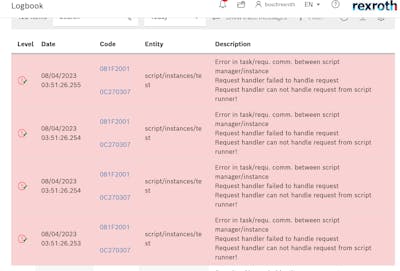

When I run the test code by selecting the "script engine" option, it's giving some errors as shown in the Logbook screenshot below.

Exiting a running script without return a "0" will always be interpreted as an error by the script engine. See this topic for further information.
