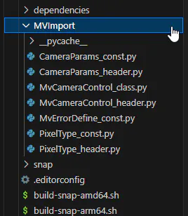

Next step is to add Hikrobot import files to the project, we can take them from our archive: 'MVS\Samples\aarch64\Python\MvImport' and create folder containing it to our project root folder:
MVImport folder also has to be added to our snap environment, you can do it in snapcraft.yaml or setup.py, I do it in .py:
packages=["MVImport"],

MVImport/
MvCameraControl_class.py
The main camera control class — enumerate devices, open/close, grab frames.

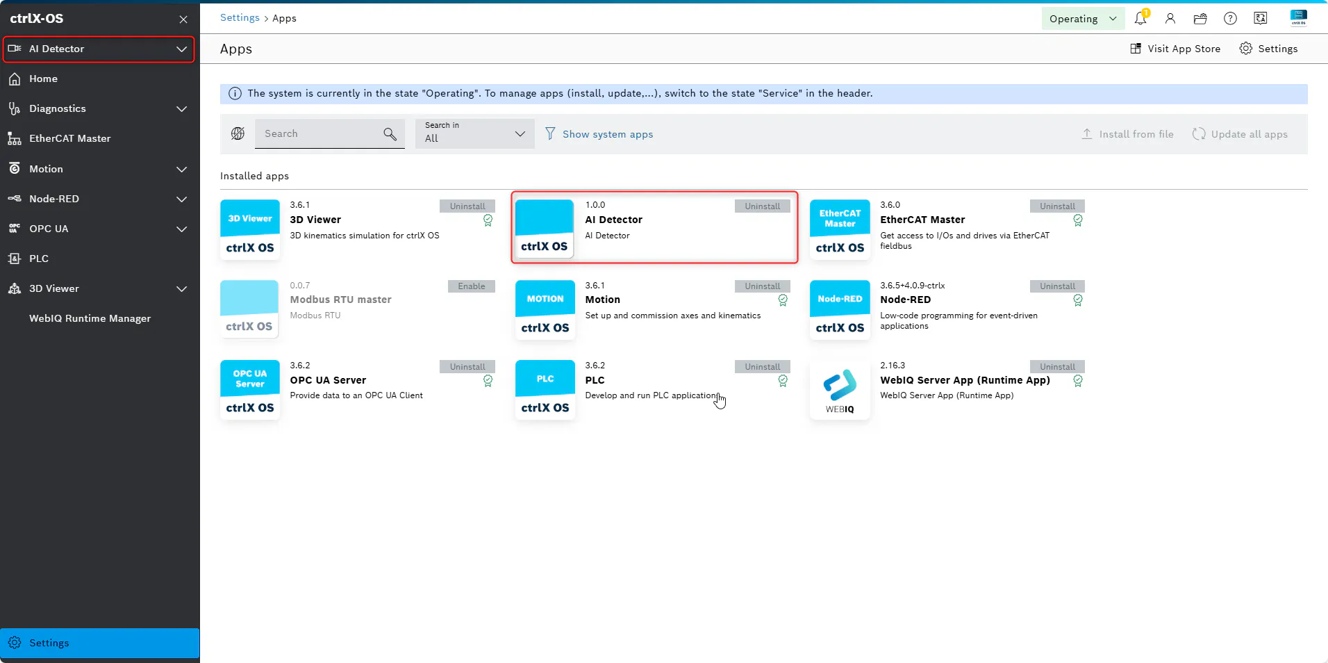

3. Install snap on the ctrlX CORE
Installing snap

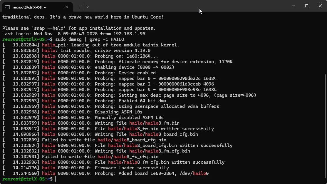

4. Check HAILO
Before running the inference, you can make sure that your HAILO chip is detected, this step is only possible if you have root access to your ctrlX CORE. Login via SSH and display messages mentioning HAILO:
ssh [email protected]
sudo dmesg | grep -i HAILO
You should see similar log:
Detect HAILO chip
As you can notice, driver version is 4.19.0, it should be same as our HAILO dependencies in Chapter 6. If you use older Firmware, you may need to change the dependencies versions and modify processing accordingly.

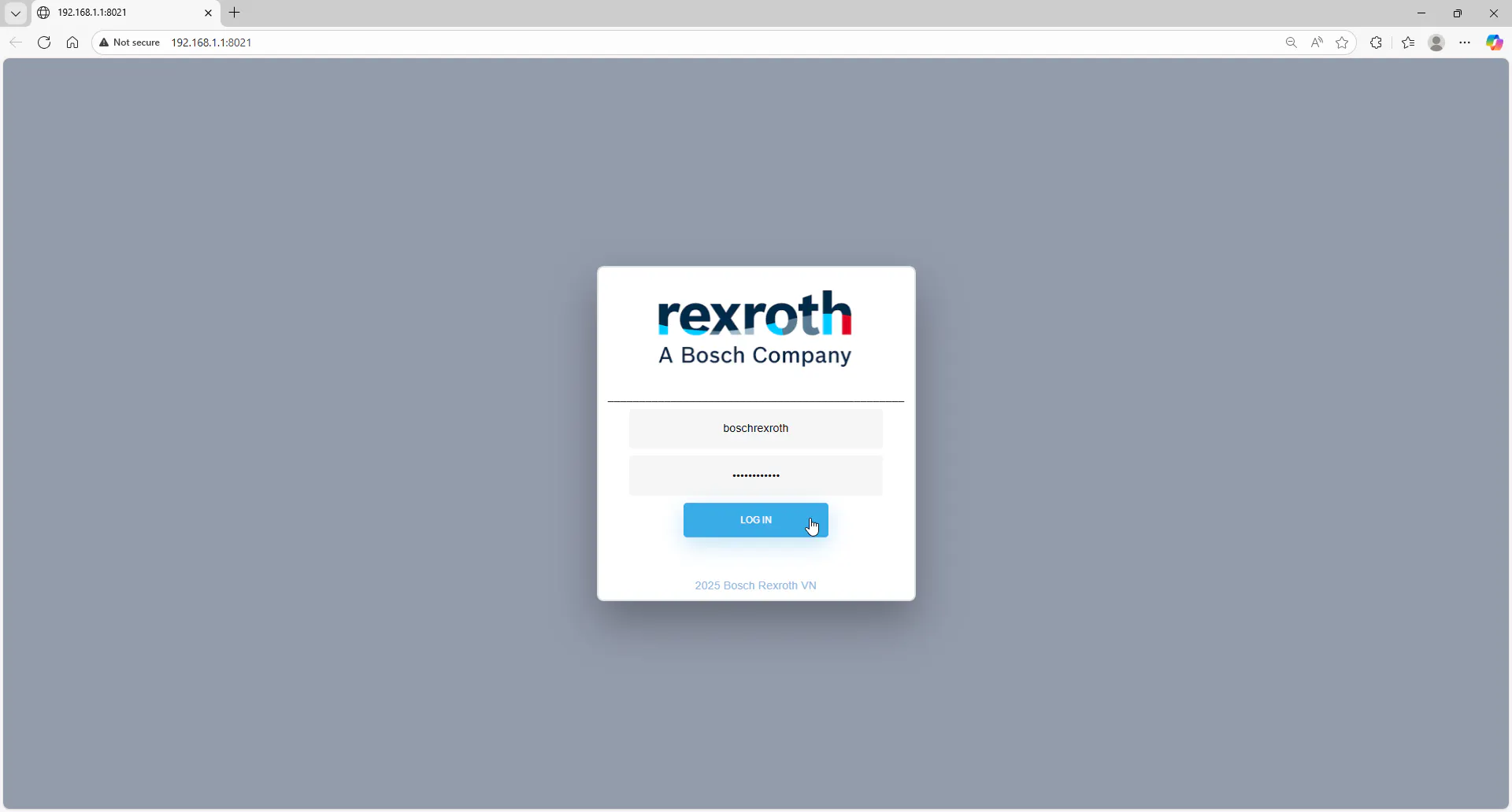

5. Run the app

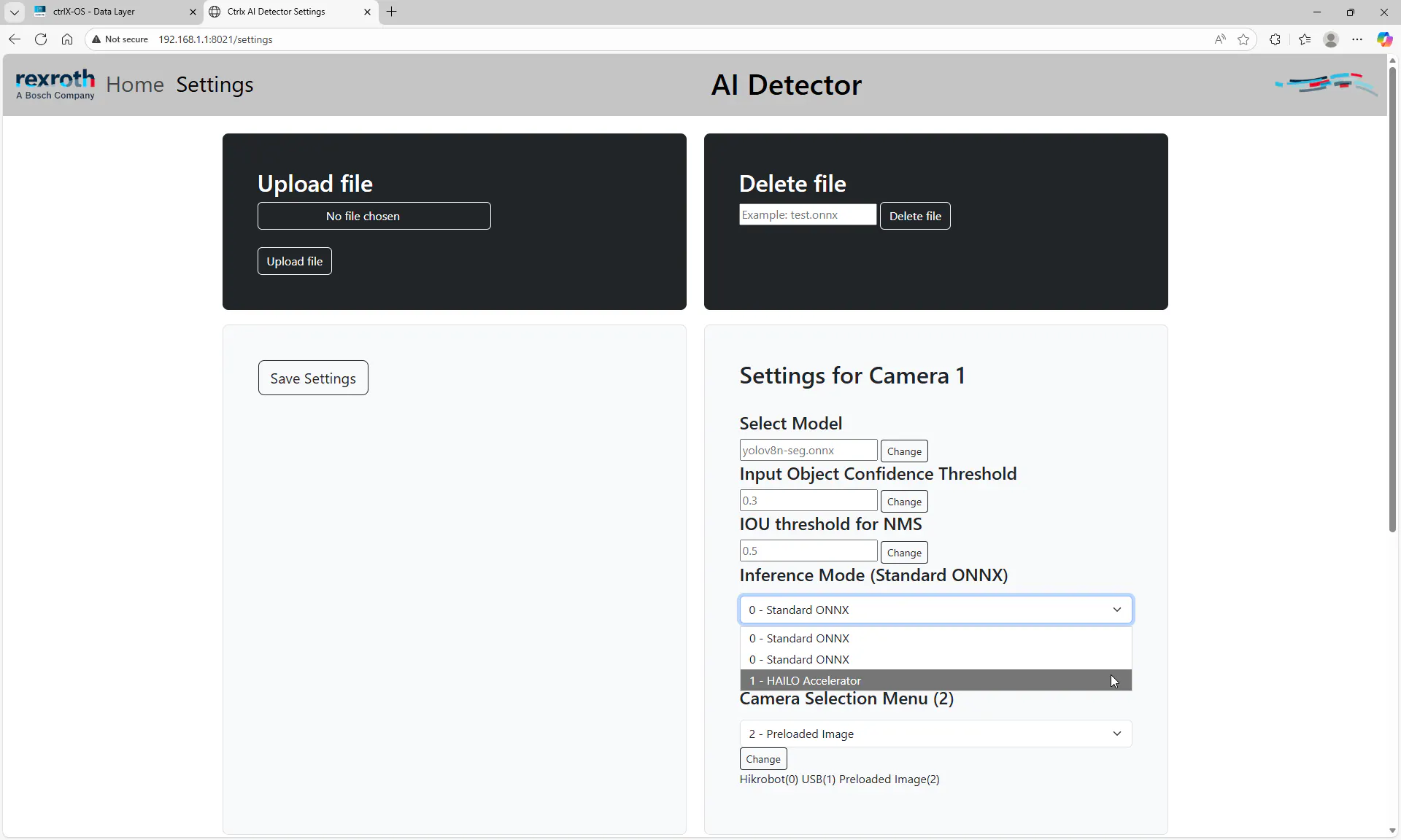

When you access the app from the side menu, you will land on the login webpage, login and password is boschrexroth:
Login.html
Browse to Settings webpage, you load/delete files, change models, select camera and enable HAILO accelerator:
Settings.html
Camera Selection

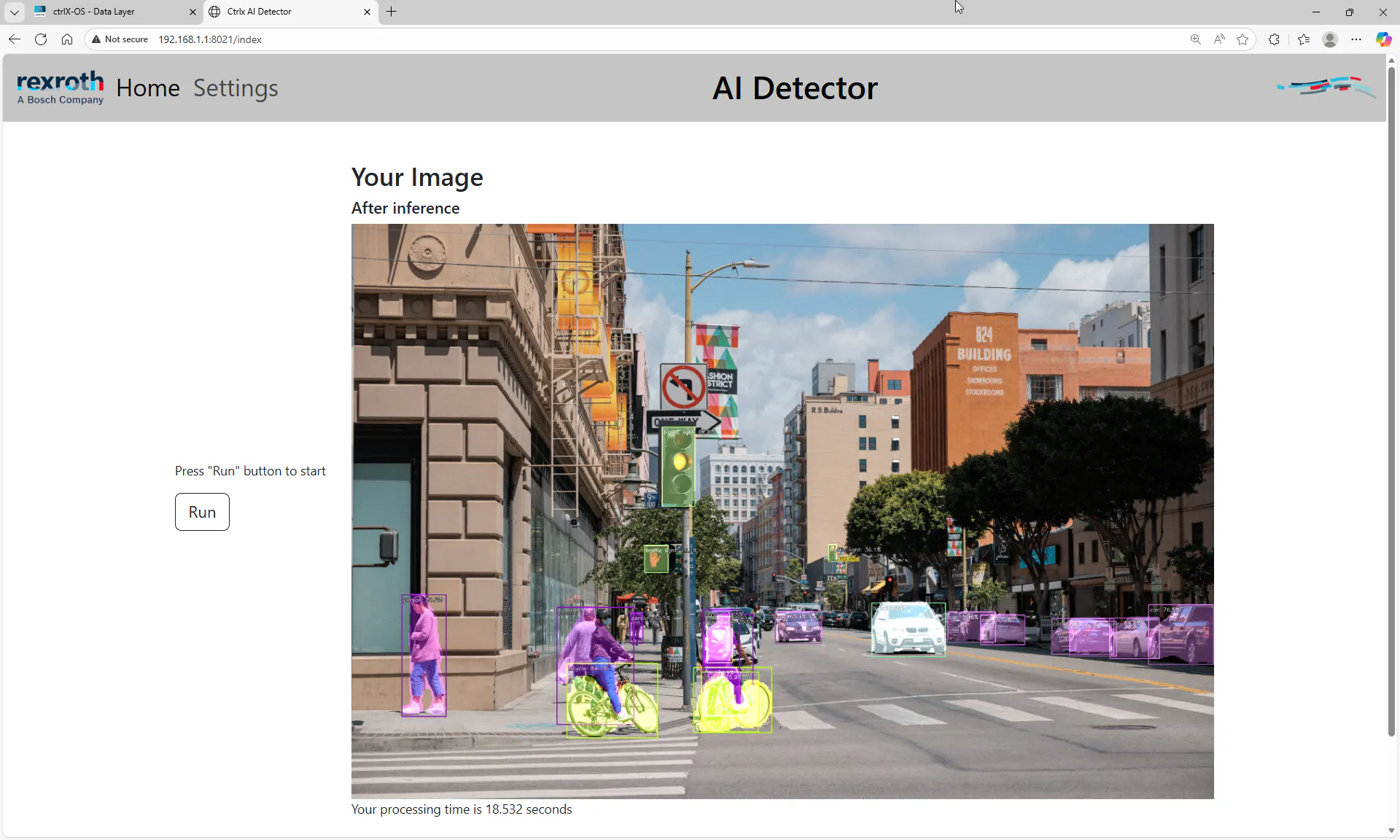

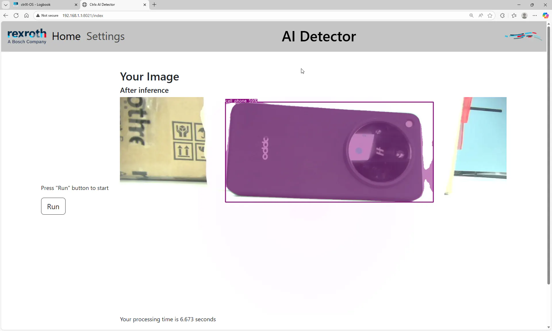

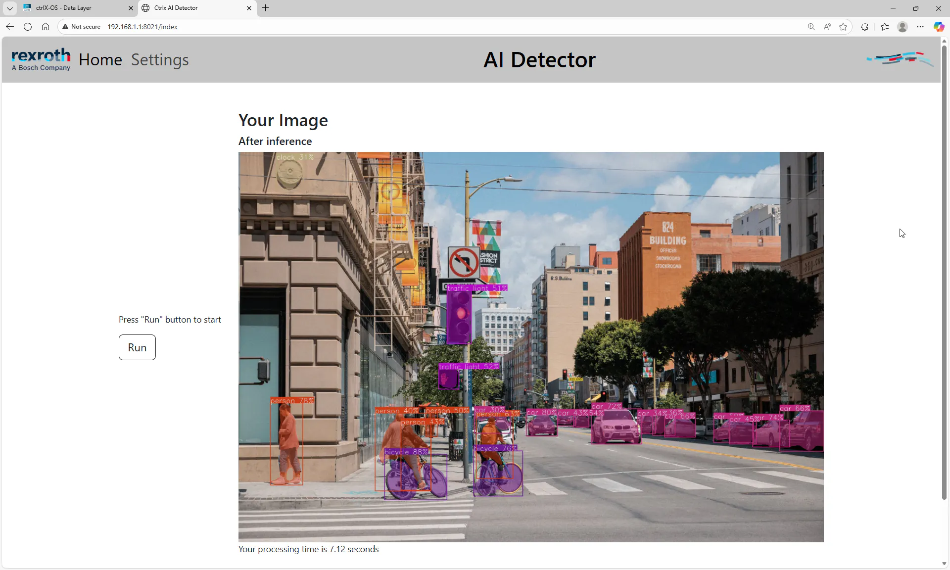

Get back to Home page and run Inference:
ONNX model processing:
ONNX Runtime Inference
HEF model with HAILO acceleration:
HAILO Inference (HEF)

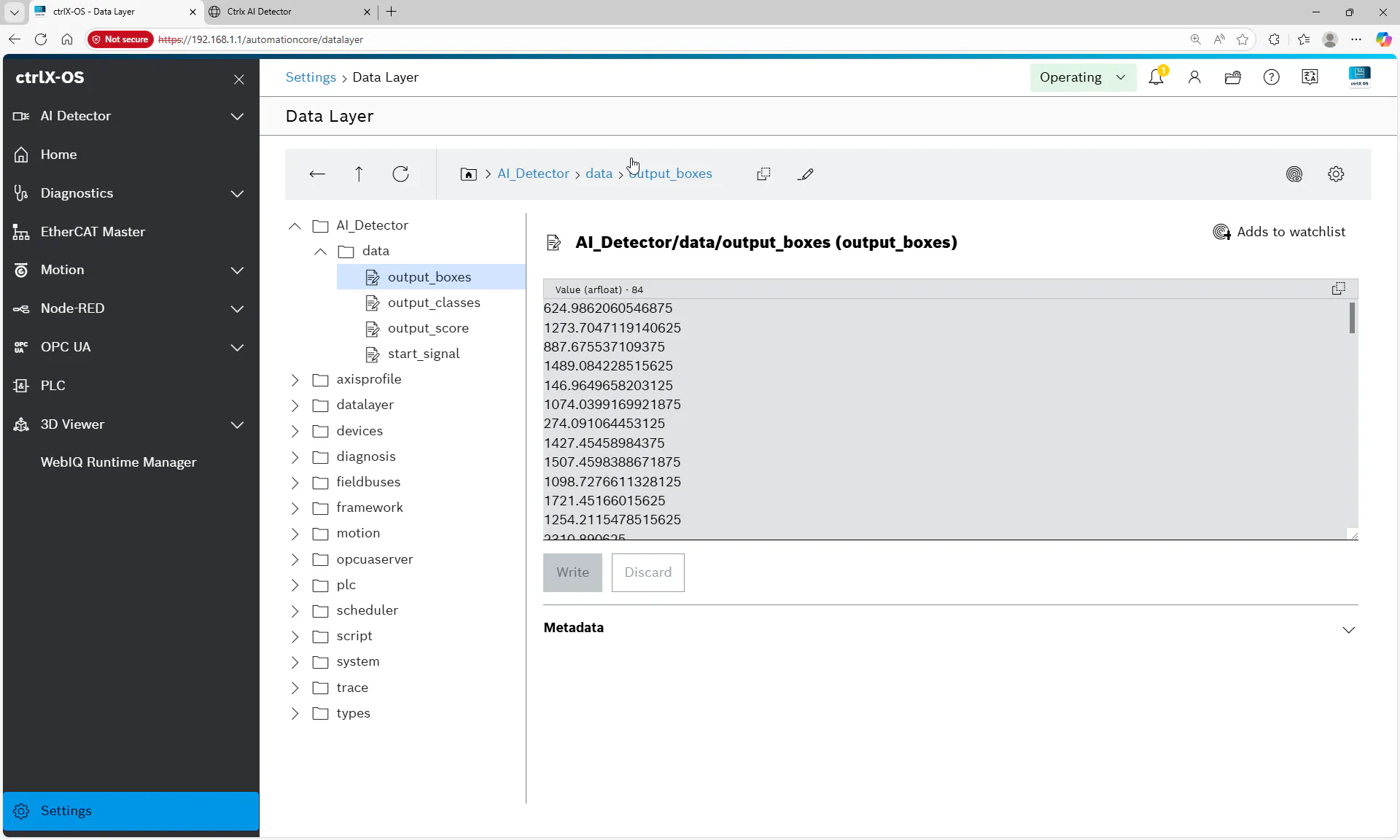

Now you can browse Data Layer for the results, you can see array of XY positions of image coordinates:
Data Layer output

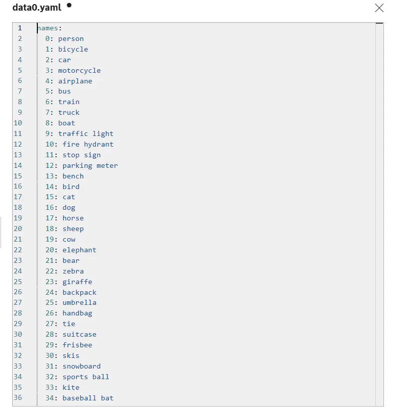

Each detection has its own corresponding class
Detected classes
You can go back and check definition of each class in your data0.yaml file:
Classes in data0.yaml

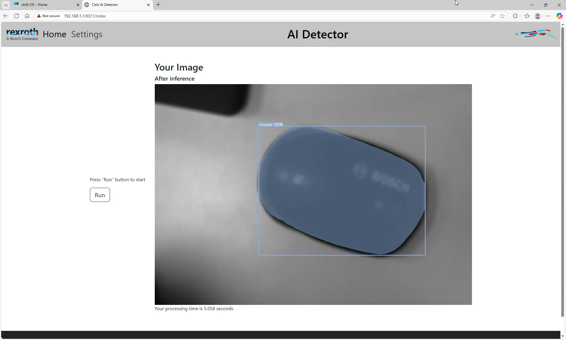

Now we can switch to using real cameras. Connect USB Webcam to USB-C port of ctrlX CORE using a adapter and set the preloaded image to USB Webcam in settings, it will detect camera automatically, and you are ready to run.
USB Webcam Inference

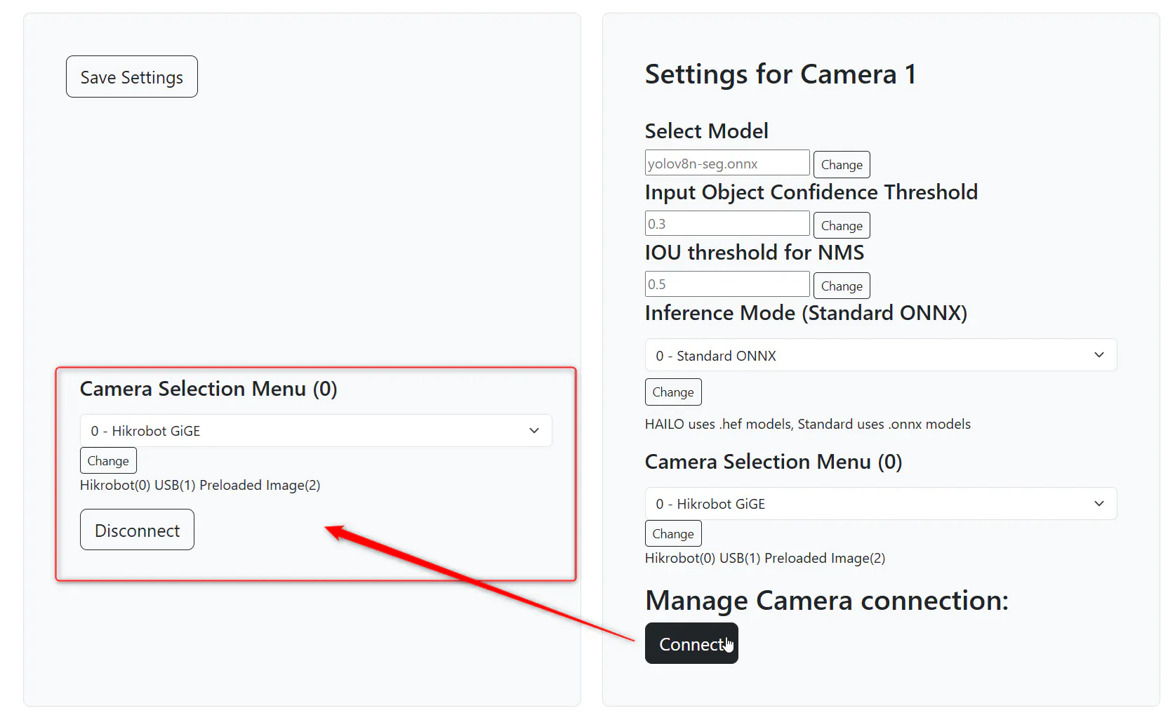

Next step is to try it with Hikrobot camera, first you will need to connect it, there is a special button in settings menu for that:
Hikrobot Connection
