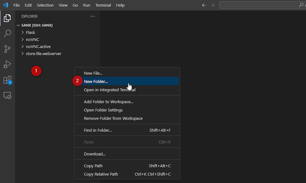

Step 2: Create project folder in the App build environment
  • Enter the app build environment and create a new folder
New folder creation in Visual Studio Code

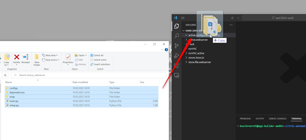

  • Extract the zip file and drag the unzipped files folders in the new created folder.
Copy folder to project folder

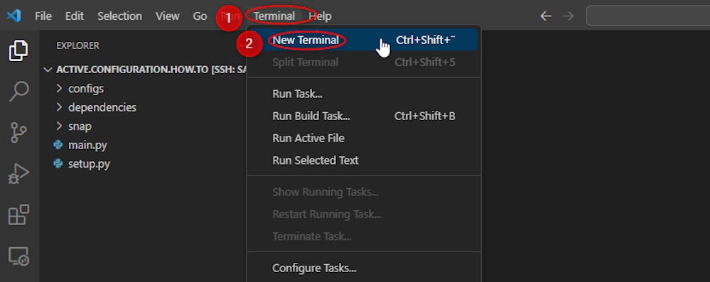

  • Press "Terminal" and open a "New terminal"
Terminal access

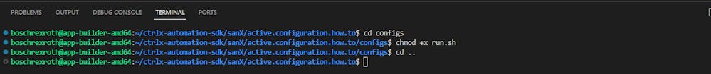

  • In the terminal, with the "cd" command, access the configs folder where the run.sh file is located:
cd configs
  • Next, use the "chmod +x" command to make the file executable:
chmod +x run.sh
  • Return to the main folder using the command "cd ..":
cd ..
Make run.sh file executable

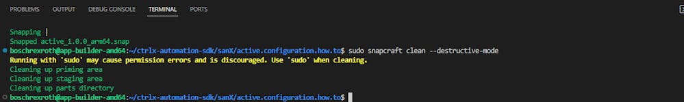

  • Clean the directory using the "snapcraft clean --destructive-mode" command:
Clean snap creation folders
