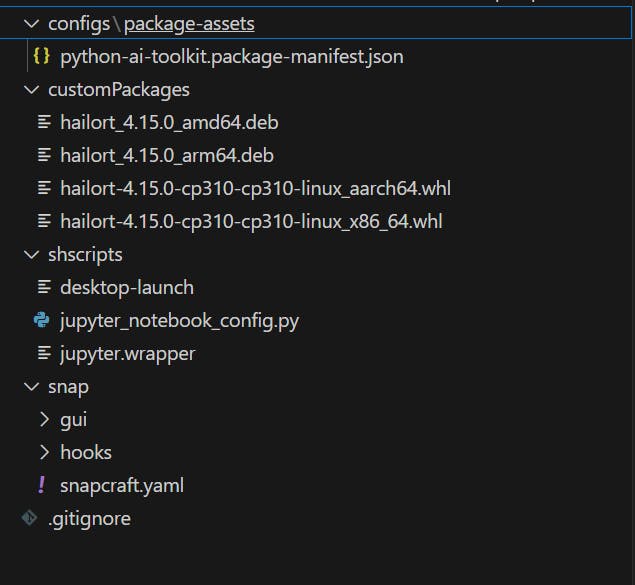

Scaffolding
The folder structure is the following:
