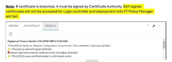

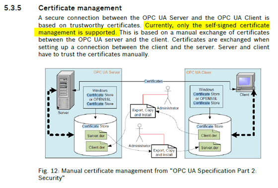

Recently Rockwell added OPC-UA client capability to the ControlLogix PLC platform. Our customer is trying to test this with the ctrlX CORE OPC-UA server app. However the ControlLogix side does not accept self-signed certificates, and that is all we support. Is there a possibility in the near term for an official published certificate for our OPC-UA Server app? The other possibility on the ControlLogix side is an an anonymous/un-encrypted OPC-UA connection. This is possible with the MLC OPC-UA Server, but as far as I know not possible with ctrlX CORE. Is this this case?
