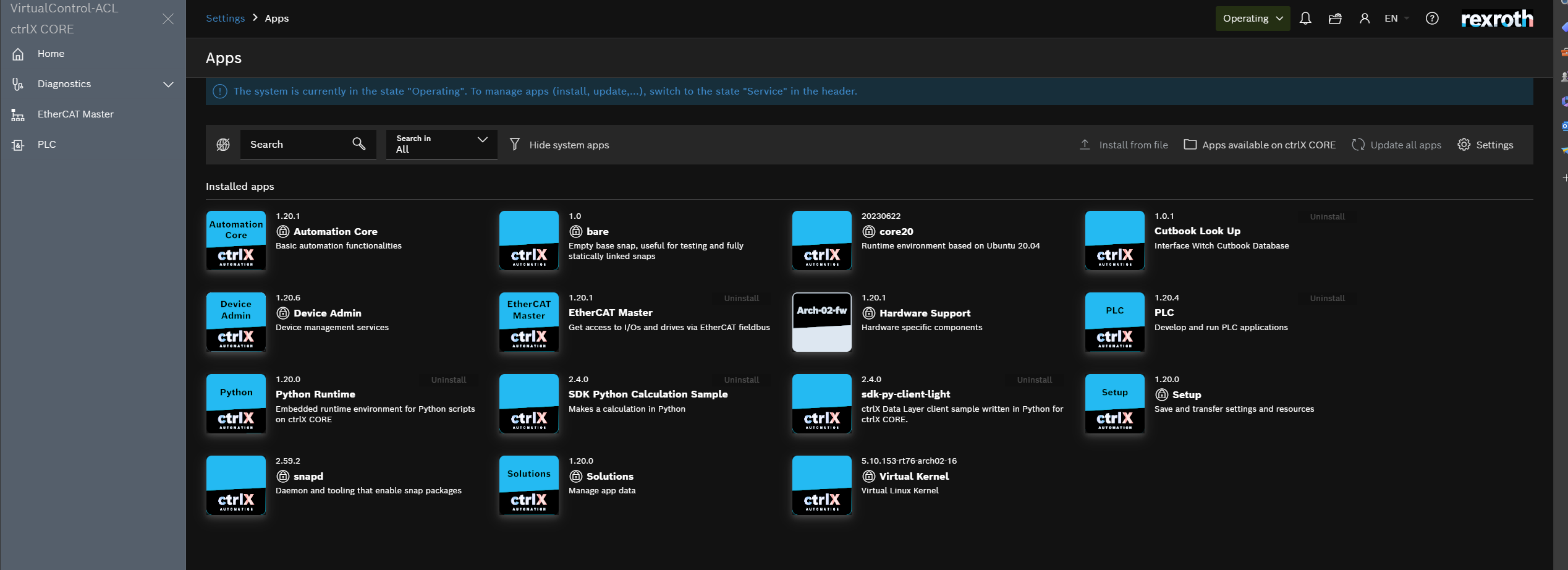

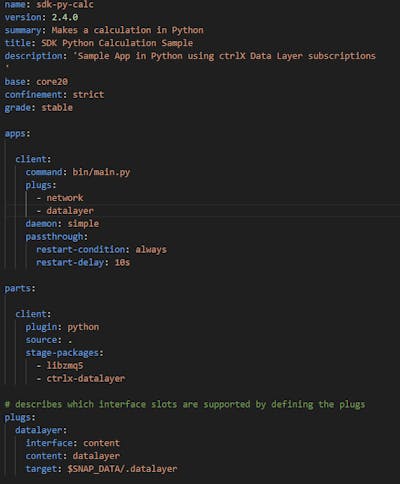

So I'm just getting started with the SDK and wanted to go through the snap process to see how it works. However when I install the snaps for the python sample projects none work as intended. They are not showing up on the datalayer. Not sure what I'm doing wrong. I'm currently working on a virtual control X core, and something else I have noticed is that unlike the introduction videos and many of the online examples my dashboard does not contain an automation tab (see attached image). the .yaml files are unchanged except that the base has been switched to a core20.ย
Maybe the command address needs to be changed?

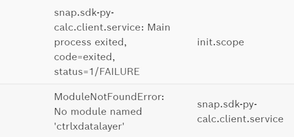

If you check your logbook, I'm guessing you'll see a similar message.
You are building these apps on SDK version 2.4 and running them on ctrlX OS version 1.20. There are incompatabilities in the libraries used across these versions. To fix this, you can build the apps on SDK version 1.20, or create a virtual CORE on image 2.4.
