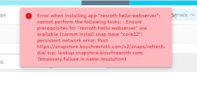

'Failure in name resolution' error when installing snap
Unable to troubleshoot the error which was encountered while installing samples from SDK on the virtual core.
The error was encountered while installing samples from Python and Go.
Base image version: 1.20.9
Like the error suggests your snaps are based on core22. Version 1.20 of the ctrlX CORE is based on core20 and cannot run this snap.
I guess you are using the SDK for ctrlX AUTOMATION in version 2.x for creating your snaps but need to use version 1.20.x. Please see this thread on how to change the SDK installation script to a fix version.
