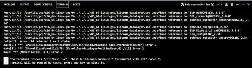

problem with snap generation
Best reply by Sgilk
That is correct. The install script will grab the latest SDK. If you want to install a specific version, you can manually download from Github or modify the install script, as nickH described in the post linked above.
