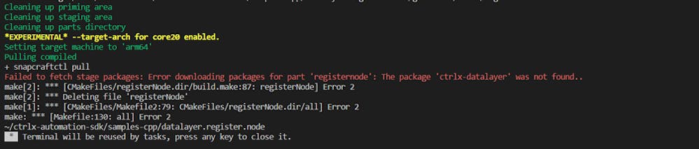

Error SDK V1.18. Not able to snap, because the package 'ctrlx-datalayer' was not found.
When I try to build my snap for the example 'samples-cpp/registernode', I get the error:
Failed to fetch stage packages: Error downloading packages for part 'registernode': The package 'ctrlx-datalayer' was not found..
I created the App Build Environment with V1.16 and downloaded the newest SDK, which is V1.18.

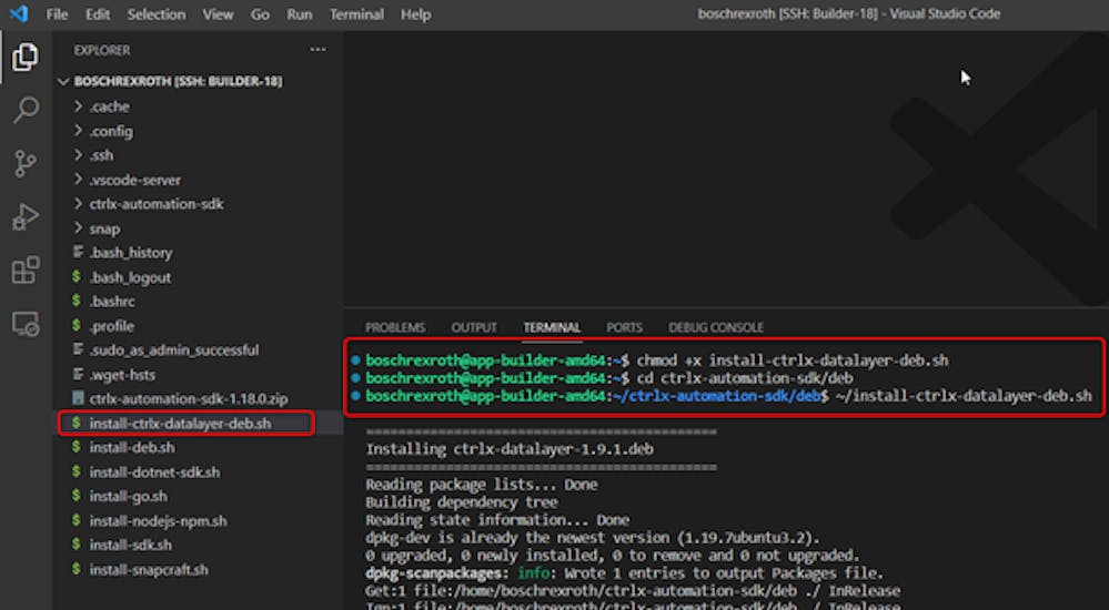

  2. If you still want to use your Build Environment (created with V1.16 or prior) or your own ubuntu machine: You can download the install-ctrlx-datalayer-deb.sh here and bring it to your build environment (drag&drop). Change the execute permissions, go to the folder where our datalayer debian package is stored in the sdk (ctrlx-automation-sdk/deb) and run the install script (~/install-ctrlx-datalayer-deb.sh).
