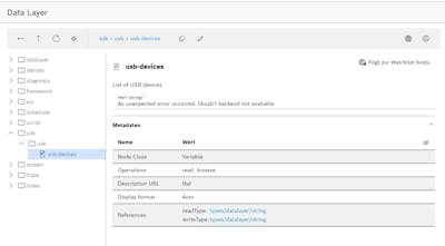

I created a node and wanted the node to display a list of the current USB devices.
However, the problem seems to be in the backend

Here you can see that the problem is the backend

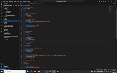

Here is my code
Snapcraft(maybe here is my fault)

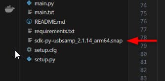

Best reply by bostroemc
Which ctrlX CORE model are you using?  I see that you have built an ARM64 snap (typ. for ctrlX CORE X3), but you have hardcoded a path with the x86_64 triplet (typ. for ctrlX CORE X7):
Maybe this mismatch is your problem.
To avoid hard-coding the target triplet, one nice option is to use sysconfig.get_config_var as shown below.
