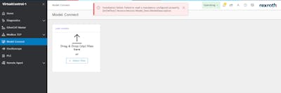

I followed the instructions for the example project cxcStateflow to deploy and monitor via Simulink and the Model Connect app. However, at the 'Build for moitoring' step, I was unable to deploy the code, Simulink returns "ERROR: Failed to send file to the model connect snap" message with no further information.
If I try to manually upload the zip files generated by Simulink, I get the following error message
/ctrlx-automation-how-tos-qmglrz33/post/modelling-deploying-and-running-simulink-r-models-on-ctrlx-os-AGTZnxw3ypHHaYG
