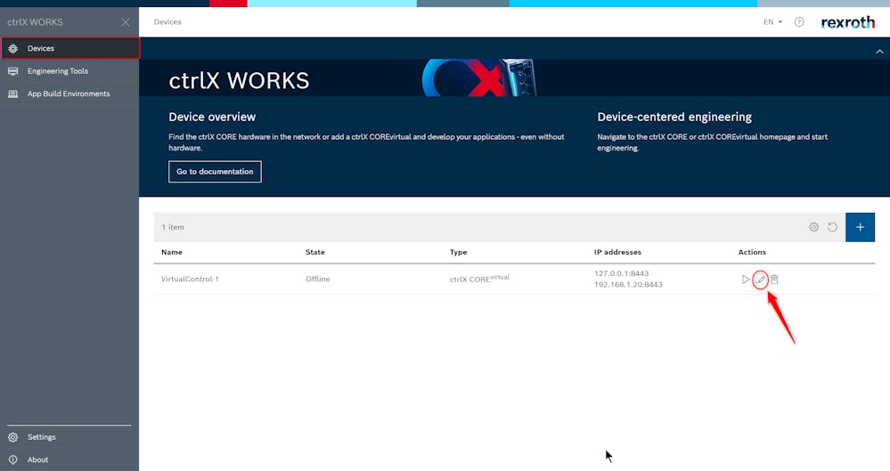

To set up ctrlX COREvirtual, open ctrlX WORKS, go to Devices and press the edit icon as shown in picture below.
setup ctrlX COREvirtual

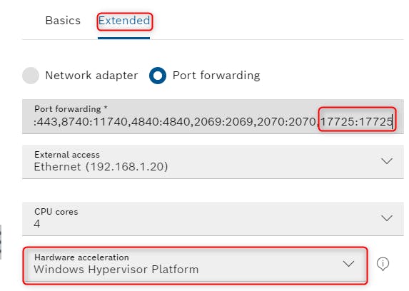

To enable external mode go to the Extended tab and under port forwarding add port 17725:17725 and under hardware acceleration choose Windows Hypervisor Platform.
port and hardware configuration

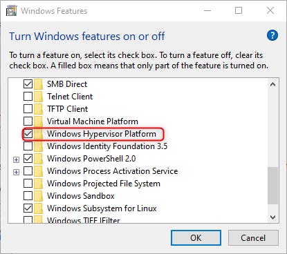

If the option for the Windows hypervisor Platform Is not available then go to the Windows search bar and search for "Turn Windows Features on or off". now check the Windows Hypervisor Platform option. Now option should be available in ctrlX WORKS.
Hypervisor platform

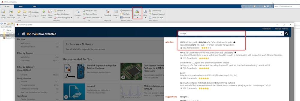

Open MATLAB and install the "MinGW" compiler from the Add-On Explorer.

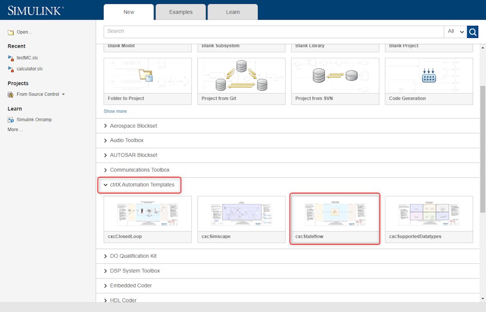

Now type 'Simulink' in the command window and hit enter. Now Simulink window will open.

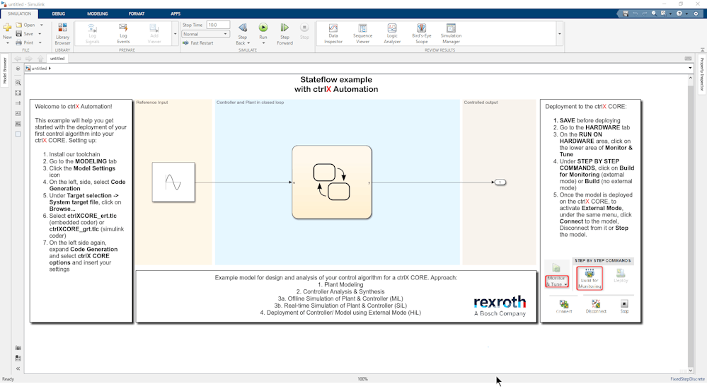

In Simulink, under ctrlX Automation Templates. there are some sample models given for the first easy deployment. choose the cxcStateflow model for example. It is a simple sine wave generator with 4 different parameters and the output will be 1 or -1 depending on the sign of amplitude.
Templates for model connect
After opening the model, the following window should look like the picture below.
cxcStateFlow Model
The description of the template features can be found there.

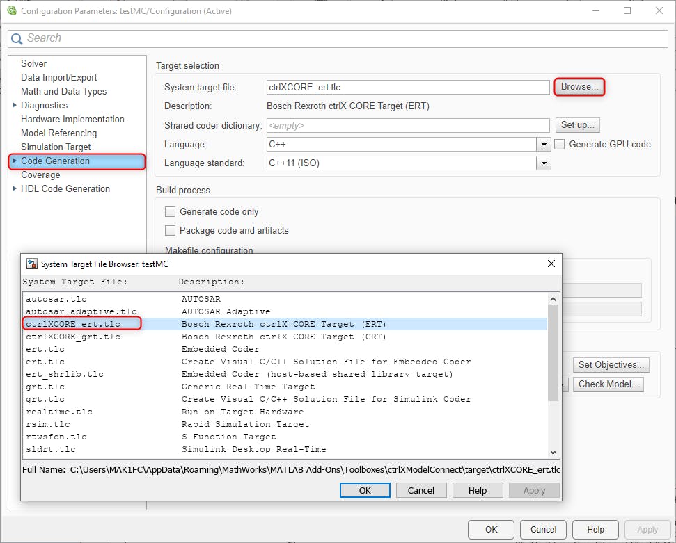

In the sidebar of configuration parameters, click on Code Generation then in the following windows click on the browse button to choose the "ctrlXCORE_ert.tlc" target file and hit the okay button as shown in the picture below.
configuration window

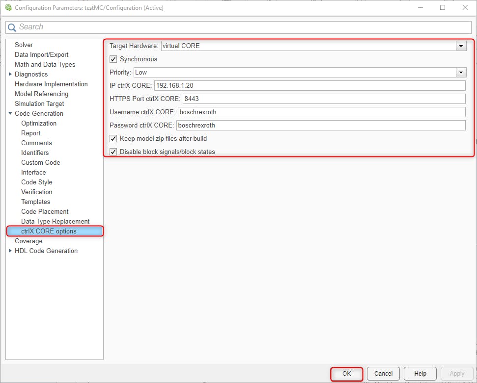

In the Configuration Parameters window, many parameters were changed in order to ensure compatibility with our controller. Some new fields are available under Code Generation. Navigate to ctrlX CORE options and configure ctrlX CORE parameters depending on real or virtual CORE as can be seen in the picture.
Core Options

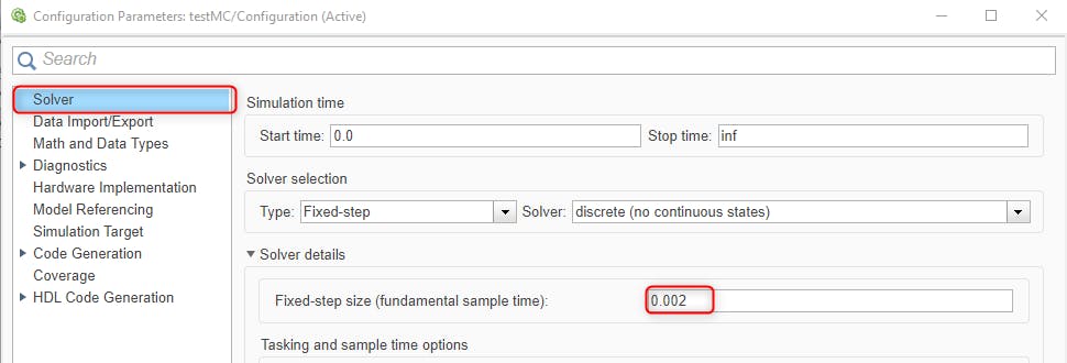

In the sidebar of Configuration Parameters, click on option Solver and change the Fixed-step size to "0.002", cause that is the minimum sampling rate on ctrlX CORE. This configuration is not necessary but If not done It will showcase an error in the diagnosis of ctrlX CORE.
Solver

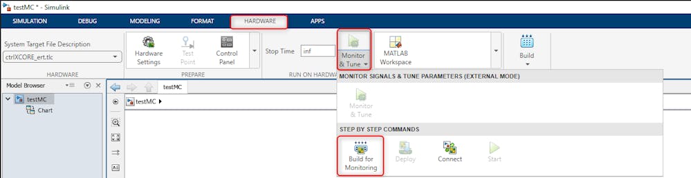

To deploy the Model on ctrlX CORE, Navigate to the Hardware tab on menubar. Now in the toolbar click on "Monitor & Tune". In the drop-down click on  Build for monitoring as shown in the picture below.
build for monitoring
This step concludes the process. After clicking this button, the model should be built and deployed into the selected ctrlX CORE.

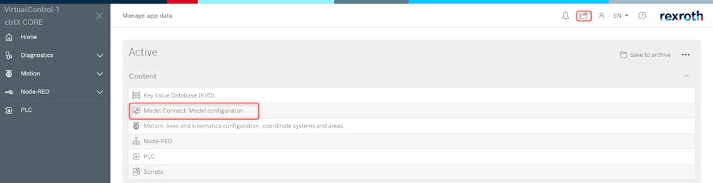

Go to the web interface of ctrlX CORE and under "manage app data" click on "Model Connect: Model Configuration" as shown in the picture below.
manage app data preview

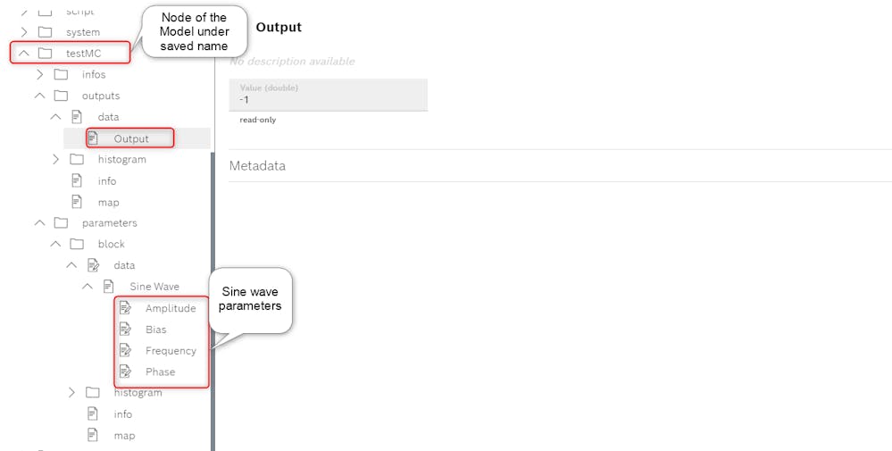

To change and review the Model parameters after deployment, you can do it either from the ctrlX Data Layer node of the model or by connecting the model from the MATLAB Simulink.
Model preview inside ctrlX Data Layer
model review in datalayer
