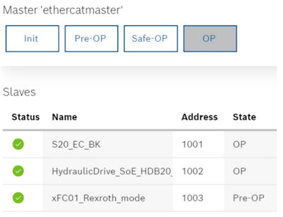

Hej,
My question is in regards to the issue specified in the following link, where I am having trouble getting my CytroPac in OP mode without initializing all of the slaves in ctrlX WORKS and putting them in OP mode again: /ctrlx-drive-5thklqt9/post/starting-the-cytropac-in-op-mode-qXWZEKzcIQ7dilY
Rather than finding out, how to automatically start specifically the CytroPac in OP mode, is there instead a way to switch the ethercatmaster between different states (e.g. OP -> Init -> OP) in ctrlX Engineering, perhaps via a parameter?

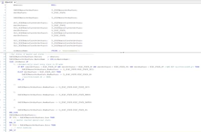

Hej!
Sorry for the late reply.
Those were some very great methods.
However, personally I ended up using the CXA_EthercatMaster library for great effect:
