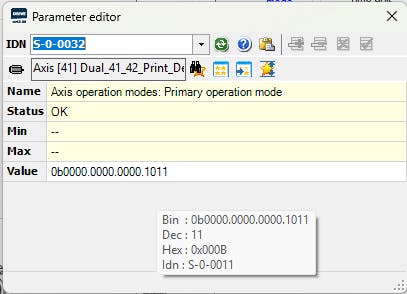

I am using ctrlX DRIVE Engineering 01V34.0, and ctrlX IO Engineering 3.6.0.
I tried saving the EtherCAT SoE StartUp list in ctrlX DRIVE Engineering.

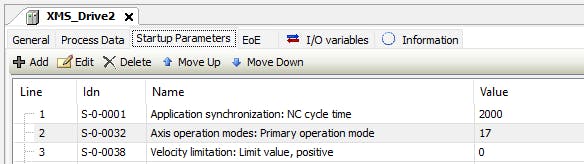

When I import it into ctrlX IO Engineering I get incorrect values. For example in the drive I have S-0-0032 set to 11, when I import the file it has a value of 17.
I looked at the XML files, the one saved in DRIVE Engineering has decimal values, and the one saved in IO Engineering has hexadecimal values.

Hello joeG,
issue is already know... Thanks for reporting...
Next release will be bugfixed,
Thanks!
