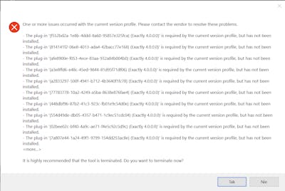

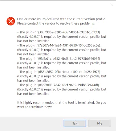

I recently installed the ctrlX WORKS v0112 package and now when I launch ctrlX DRIVE and I/O Engineering i get warnings listed below. What should I do with this issue?

It finally worked by taking the following steps:
  1. deinstalation
  2. instalation
  3. adding the file to the folder according to this thread
  4. conducting repair installation
Thank you for your assistance!
