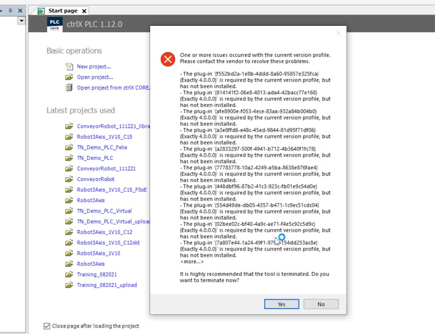

Missing plug-in 4.0.0.0 error opening ctrlX PLC Engineering 1.12.0

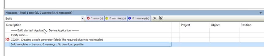

Since updating to ctrlx WORKS 1.12 I am always getting the error below when I open PLC Engineering. If I click 'No" to the message I can make a new project, but then I get an error message when I complile (see below).
I have tried multiple times uninstalling and reinstalling ctrlX WORKS but always run into the same issue.  If I install ctrlX WORKS 1.12 on a Win10 virtual machine, I do not get this error.  So I guess there is a unique problem on my Win10 host operating system. But if I reinstall ctrlX WORKS 1.10 on my host operating system, that one is still working fine.
Brian

Hello Brian
it is a known problem with Bosch PC after the automatic Update of an Outlook Addin.
Workaround:
Copy the attached file (PW: Bosch) SQLite.Interop.dll to the folder <Installationpath>\Studio\Common and start repair-Installation
Regards
Jochen
