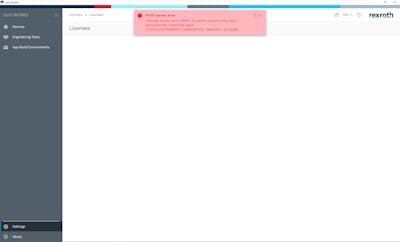

I am using a Virtual Machine to run ctrlX WORKS. In my VM i'll get the following error when I am opening License in WORKS:
(Error text: HTTP server error
Internal server error (500) · A service system error was encountered: Failed file open. [1,7E5,9,0[73000041,5,400703F3]] · 080F0200 · 0C7A0200)

As you registered your PC and ctrlX WORKS in our licensing center to generate a license file, this file is bound to your unique Windows ID and cannot be used on several PCs. Therefore you need to go through the same process inside your VM and get another license to be able to work with it.
