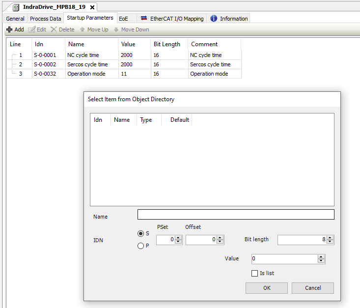

I am able to add startup parameters to a ctrlX drive in ctrlX IO. When I try the samething with an IndraDrive I am not able to add any parameters to the startup list.
I have attached a picture, when I click OK nothing happens regardless of the name, IDN, bit length and value.
In the version 1.16 releasing the next days it is possible to add startup parameter by hand. The list will still be empty.
UPDATE: Update: The release 1.16 is now available at the Collaboration Room (PT area)! Please get in contact with your known sales contact person to get access.
