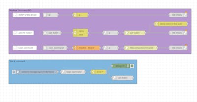

Here my sharing : interfacing with NR and REST API.
This is modular and "nocode"
Just need to provide Username/Pass and IP
PS : Please rename the extension file txt to json
Please have a look to the node-red-contrib-ctrlx-automation nodes we added as palette to Node-RED and see the corresponding examples.
