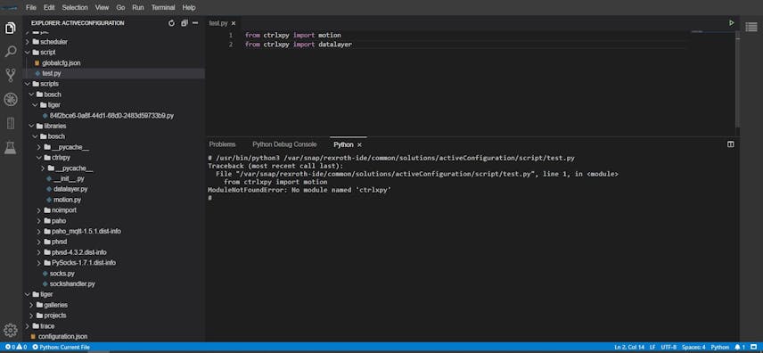

I tried the "from ctrlxpy import motion" in the textual IDE App but failed with 'ModuleNotFoundError'.
And in comparison, I tried with "import time" and it works.ย
Here is the screenshot.ย
Thanks and best regards,
Hui

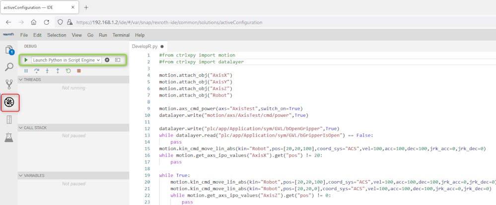

These modules are only kind of header files so that auto completion will work. So only needed for programming. The function itself is bound into the kernel and will work when you run the script on the ctrlX CORE:
EDIT: See DeleopR series two episode 3 how toย for further information. Or see "Collection of How-to blogs and videos for ctrlX AUTOMATION" for all how to blogs and videos.
