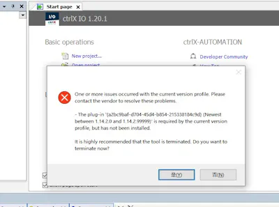

Error occurs when startup the IO Engineering.
After finish installing the ctrlX works1.20 (1.20.2 and 1.20.4 all have this problem, not sure other version have or not.), you will get error when you run IO Engineering. look error below.
looks like the installation miss something. This has already happens to several customers and does any one know how to solve it ??

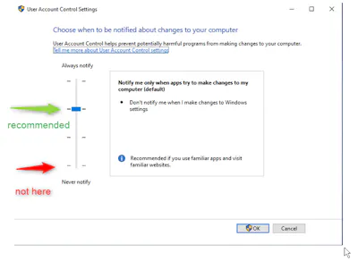

3. Switch Your Opperating-System-Language to ENGLISH or GERMAN
4. Check Your User-Accout Settings
