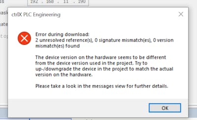

I faced an error that while using Codesys Add-on(In my case, Ethernet/IP codesys package is used)
my Ctrlx COREVirtual:1.12.70
my ctrlX WORKS :WRK-V-0112.9
my codesys add-on :4.4.0.0/4.2.0.0
And here is the error outpout in the message window:
[FATAL ERROR] Unresolved reference: 'CODEMGETCONTENTBYFIRMCODE2'
And this error is shown while I login.
