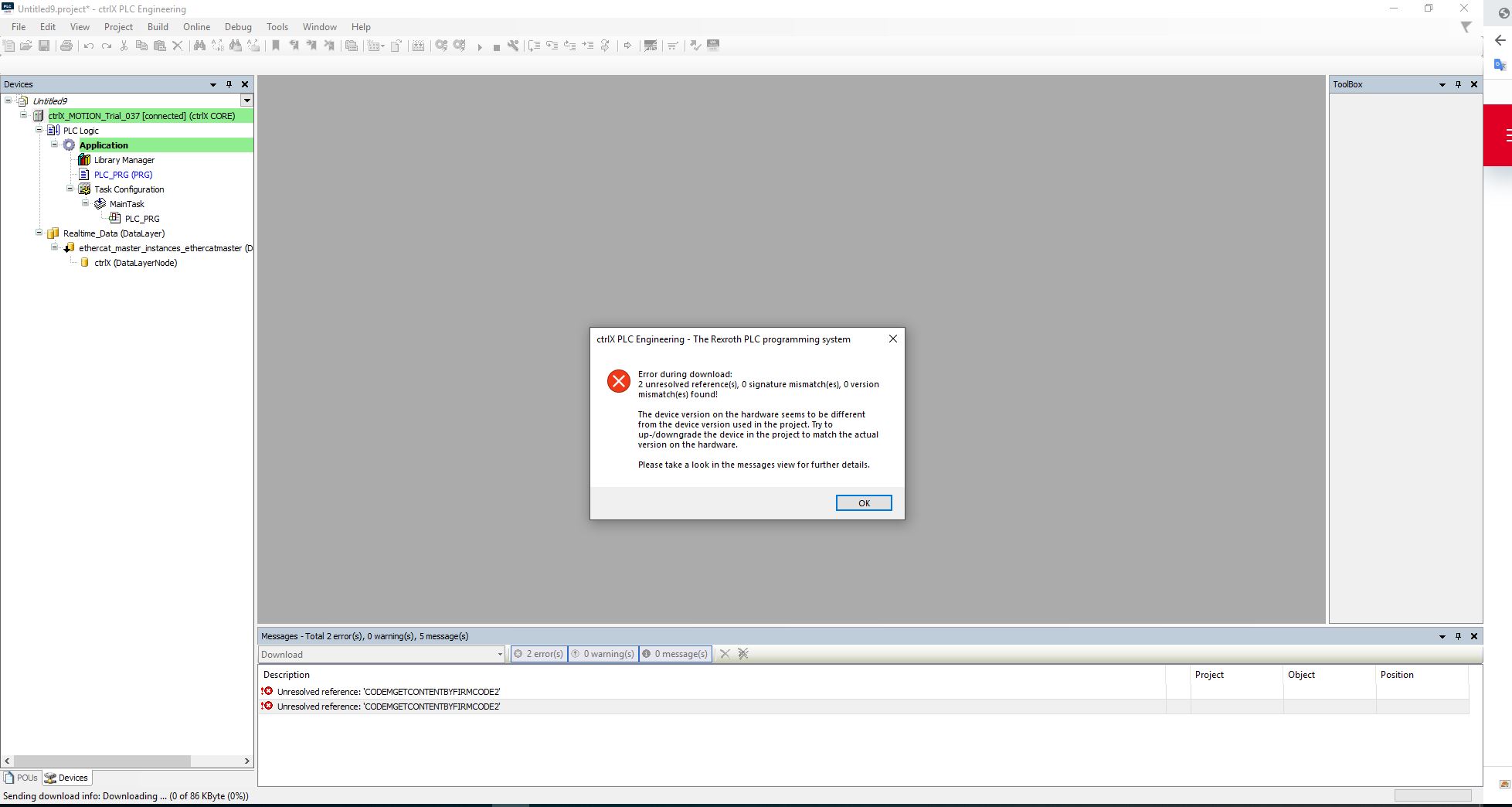

After I finished the setting up of the EtherCAT configuration, IO setting and Axes configuration, I tried to use PLC Engineering to compile a small program to drive the motor of Demo kit.
When I click the login button of ctrlX PLC Engineering, it got the error showed that the device version were different between project and actural version on hardware.(attached pic)
It also showed the error "Unresolved reference: 'CODEMGETCONTENTBYFIRMCODE2' on the message box.
How could I solve this error?

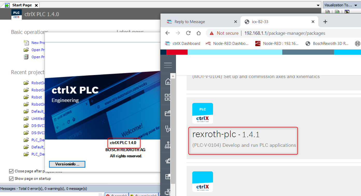

Hello Wesley,
You may be using the 01V04 version of PLC Engineering with the 01V02 version of the PLC app in ctrlX CORE. In this case you need to update the app to 01V04 (see image).ย ย
Brian
