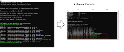

I followed the video (How to video. ) instructions to the letter, however when I type in the terminal "ll" I don't get the installs as in the video. Does anyone know why?
Â
Â
Hi Josaphat_Diaz,
in the video on YouTube still version 1.14 is used. In newer Versions these install-scripts are in the folder "scritps". So to download the ctrlX SDK from GitHub and install it into your App Build Environment use the following command in "~": "./scripts/install-sdk.sh".
Which version are you currently using? If you are using V1.20 this community post is important for you.
Best regards,Â
Nick
