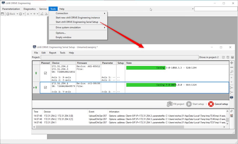

With ctrlX DRIVE Engineering we can backup and restore the parameters of an indivudal drive. How can we do many drives at the same time? Is this somehow supported by the Drive Connect app? Maybe possible in RM22.11?

You can use the "Serial Setup" tool that is part of ctrlX DRIVE Engineering. Beware that a own license (R911396394) is needed for using all its functions. This tool can also be automated e.g. via abatch file:
The DriveConnect App started with saving (version 1.16) and loading (version 1.18) single axis parameter files.
