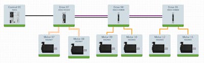

I am making a configuration on CtrlX Configurator, please find the configuration image attached. I can see that the Mains filter size is automatically choosen, with the current configuration with XCD2323 DC bus coupled with 2 XMD0606 i get 16A mains filter, but i feel it has to be 30A mains filter.
Question 1: can we change the mains filter size in the configurator in the XCD2323 configuration or we need to add it separately by selecting the XCD2323 without filter option?
Question 2: Is my calcualtion correct or is there something I am missing?
COuld any one please help me with this?

Hello Tasty_Tech,
for selecting a mains filter, the mains input continuous current in A is relevant.
XCD2-W2323:
Mains input continuous current at ULN_nenn and PDC_cont (three-phase, with mains choke) in A (ILN) = 15,9
Mains input continuous current at ULN_nenn and PDC_cont (three-phase, without mains choke) in A (ILN) = 8,1
NFD03.1-480-016:
Rated current mains filter in A = 16
Looking at the current, the mains filter fits to the converter. If a deeper consideration is required please contact our colleagues in product management.
