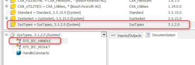

I want to use the FB "IL_TCPConnectionAsync" and I can't find the lib where the data type "RTS_IEC_HANDLE" is included.
Do you know where to find it?

Please check whether SysTypes has installed in your PLC Studio.
