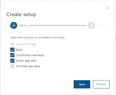

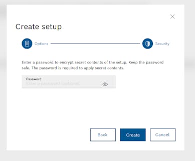

Create setup: select the ressources to be added to the setup and encrypt the file.
Select the resources to be added to the setup
Encrypt the file

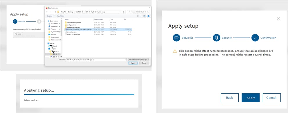

Apply setup: select a file and apply the setup.
Select a file and apply to setup
The desired settings have been transfered on the device.
