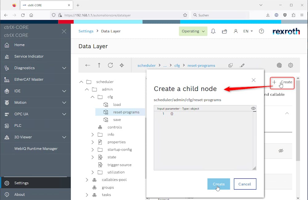

You could try to reset your scheduler configuration so it will be auto generated with correct settings: Switch system to setup and send {} to "scheduler/admin/cfg/reset-programs" via the data layer. Afterwards delete and add your EtherCat master to also get the correct scheduler settings for this app. To be sure you could save your active configuration (app data) afterwards.
ctrlX CORE web UI - reset scheduler configuration via data layer 
Afterwards use the create button under save and send { "configurationPath": "", "id": "", "phase": "save" } to permanently store the new configuration. As EtherCat master is installed also delete your master instance and create a new one to generate corresponding scheduler configuration.
