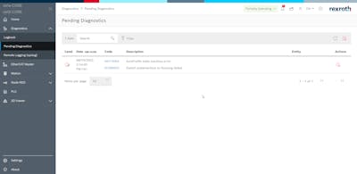

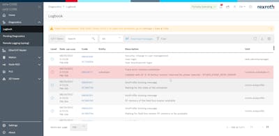

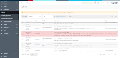

Here is some error messages that I could catch:
โ€ƒ
โ€ƒ
