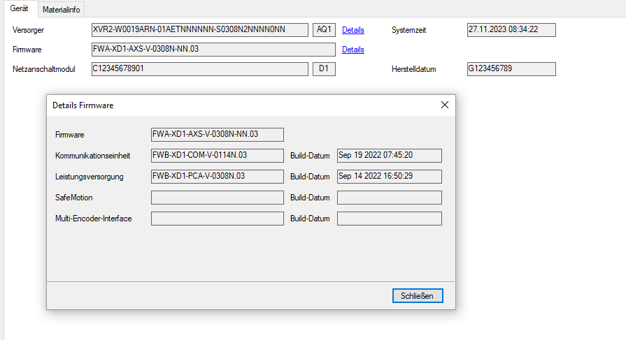

we have a XVR2-W0019 (with XLI) in a Drive application.

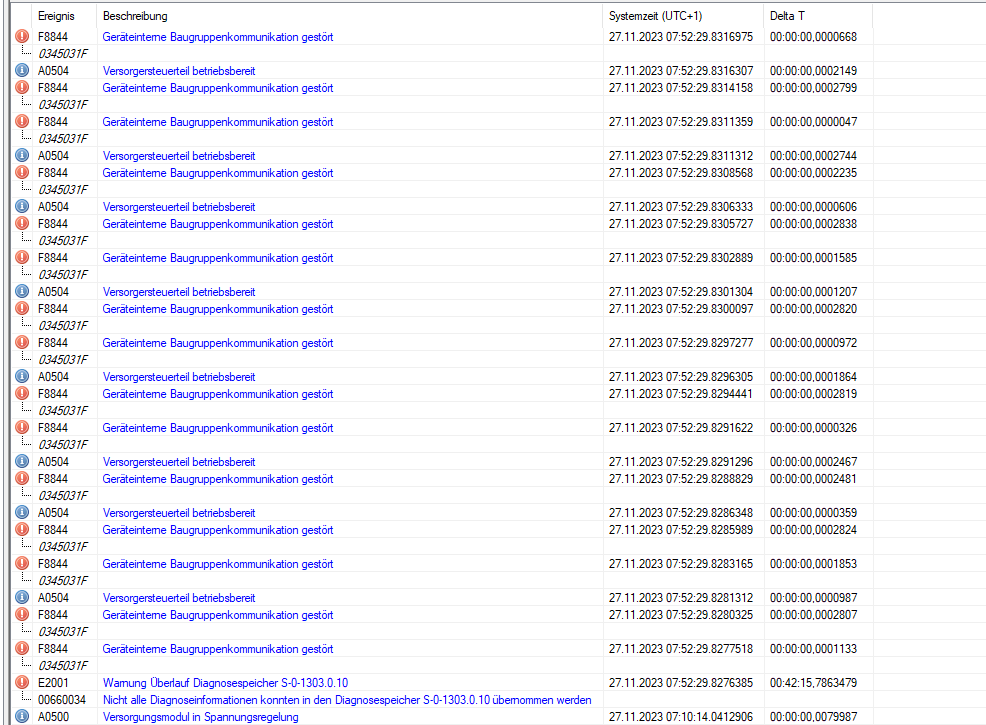

Since last week we temporarily get the Error F8844 wiht detail diagnosis 0345031F (i found no documentation for the detail Diagnosis).
We are not able to reset the error via Drive engineering or via the command "C0500", after a power off- on of the system the XVR works again- sometimes for only a few minutes, sometimes for the whole day.

In our system we have two asynchronous motors with a 24V brake, the brake consumes 1.6A so it was not possible to control it directly with the XMD2 W1616. So we control the brake with a additional relais. When the brake closes the magnetic coil gets deactivated andwe got a inductive peak voltage on the 24V system (only the drives were on that 24V circuit, our ctlx Core is in a other 24V circuit) for about 1ms (we inspechted it with a oscilloscope). So we installed a supressor circuit at the motor brakes. Now the peak voltage is nearly gone and the error didnt occur since two days.
