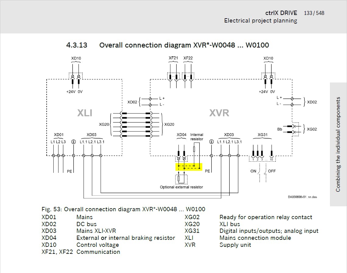

Does the internal brake resistor for the XVR2*-W0048 have to be wired by the customer? On the overall connection diagram, the connection is shown as a dashed line.
If it needs to be wired by the customer, which cross-section is recommended?

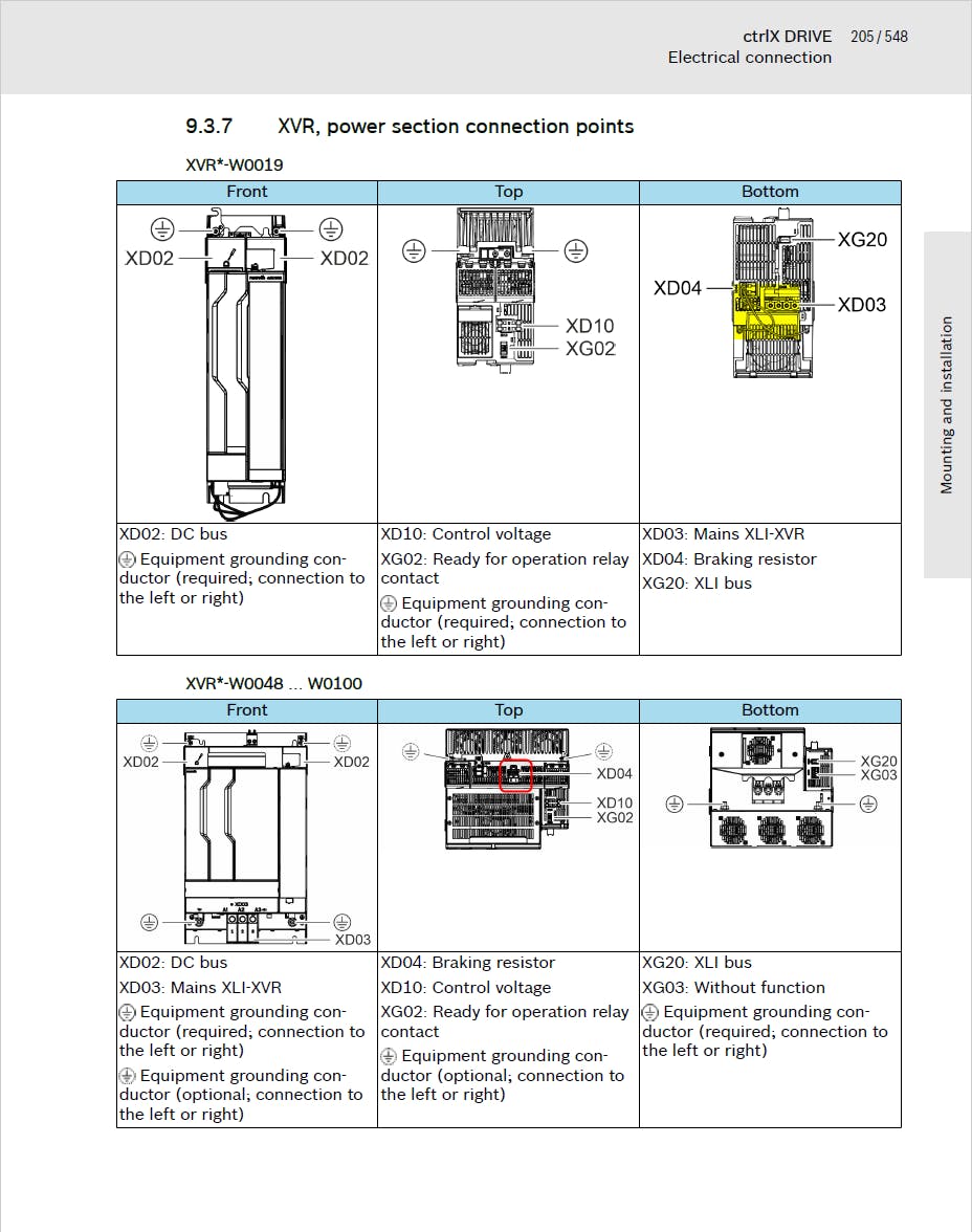

With the XVR2*-W0019, the brake resistance appears to be wired from the plant, as can be seen in the figure in the chapter "9.3.7 XVR, power section connection points".

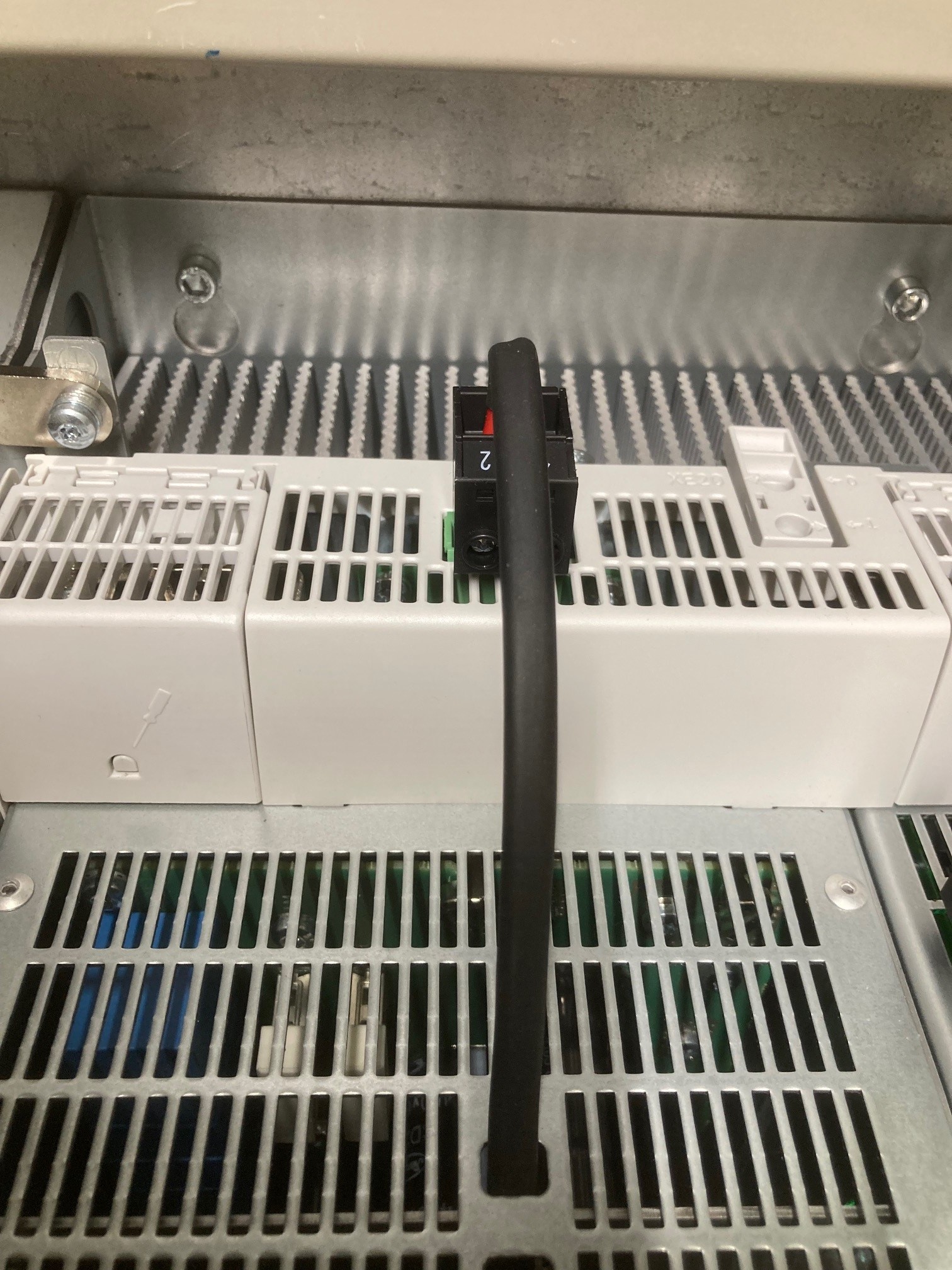

Best reply by Drives_Uwe
It is already wired ex plant. See
