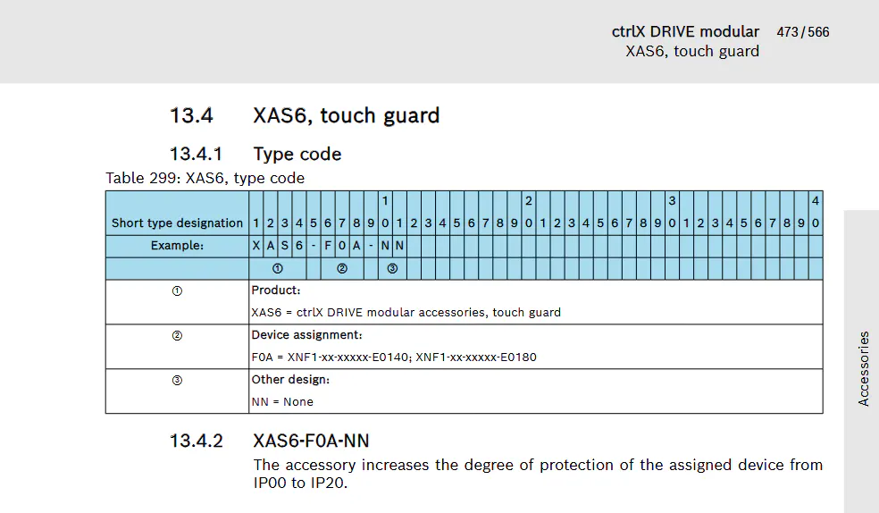

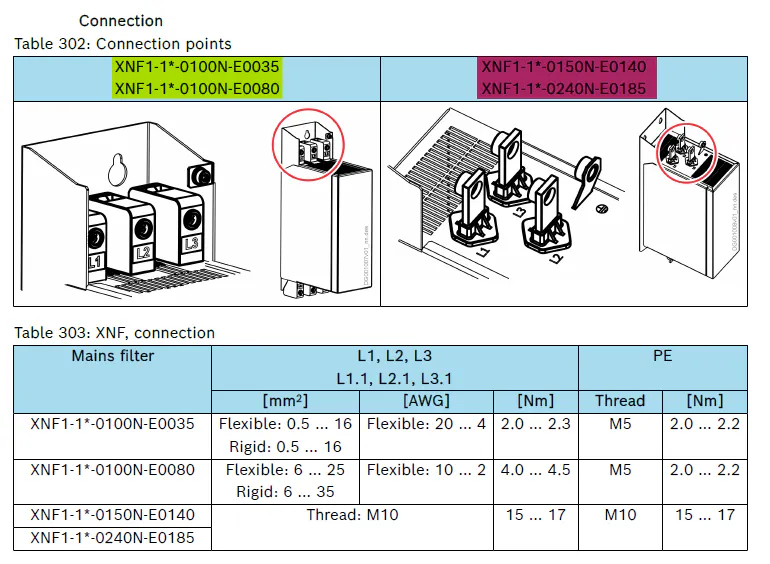

We are wondering if Bosch Rexroth offers a touch guard for the higher current XNF filters (XNF...150, XNF...240) for protection.
If not, do we have recommendations on covering the lugs?
Thank you!
Best reply by StefDu

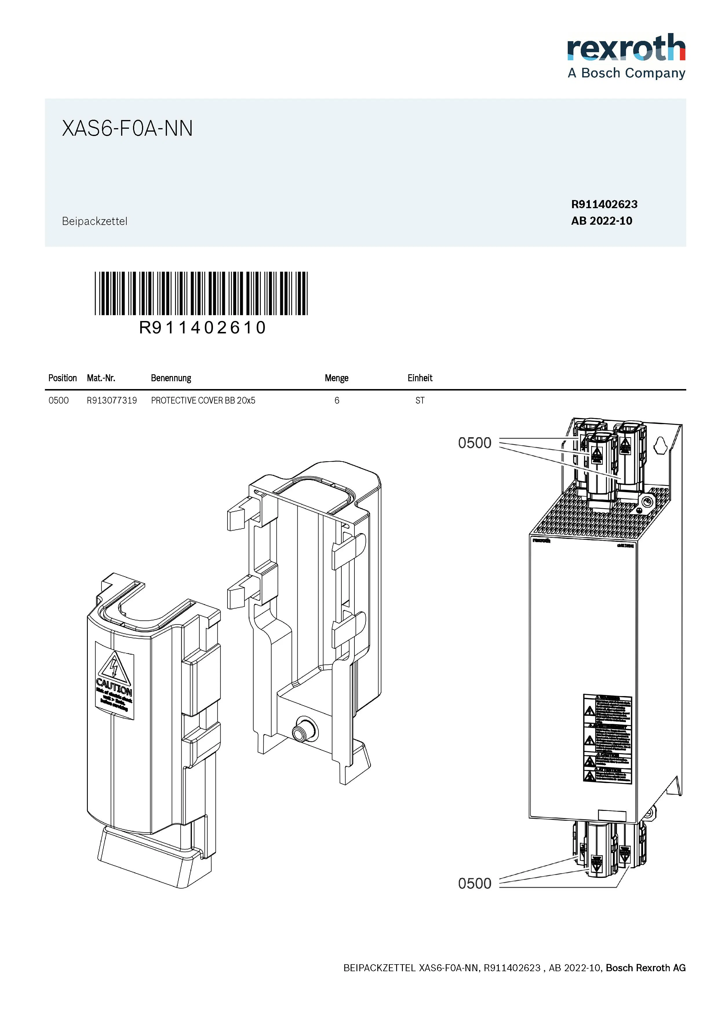

these touch guards are available in the accessory kit XAS6-F0A-NN
regards,
Stefan
