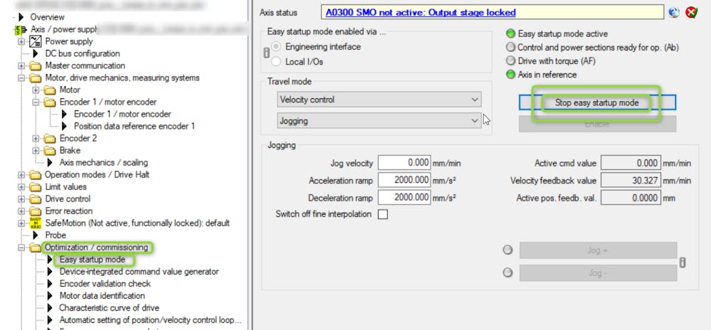

What does it mean by A4003- Setting-up mode is active, and how can we remove this status.
What does it mean by "A4003- Setting-up mode is active" status in the drive HCS02 while trying to run using software. and i would like to know how to remove this status and run the drive using software. thank you
Best reply by Drives_Uwe
This means that the so called "Easy Startup Mode" is active. You stop this mode by pressing the button "Stop aasy atartup mode"!
hi thank you for your respons. and my plan is run using easy startup mode in V/f function.
so i have already change functional packages to V/f mode and loaded basic parameters.
And also no output at the time of "setting-up mode is active" status
then how can i run if i stop easy startup mode?
