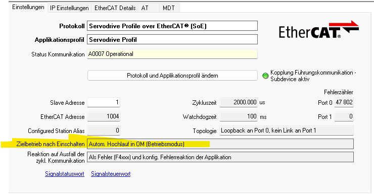

Keep drive in CM/PM after power on instead OM
I'd like to keep the drive in CM/PM after power on and not switch to OM.
Drive should go to OM if PLC (ctrlX) is ready and EtherCat running (in OP).
In settings there is this:
This is P-0-4088 but how to change it. With IndraDrive CS there was an option to switch but I don't see it in CtrlXDrive.
Thanks again for help
