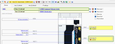

Does ctrlX Drive STO Safe torque off have also SBC (Safe Brake Control)
In ctrlX drive we have T0 for STO. In Indradrive we had L# and L4 (L4 has also SBC). I dont find this in the ctrlX Safety STO manual.
Does that mean that the holding brake wiring is not interupted bij the TO STO function. So it must be bossible to release the brake (over the function) while the drive is in STO ?
Best reply by StefDu
for SBC an option "Mx" is needed in the drive.
With the T0 option it is possible to release the brake when STO is activated.
