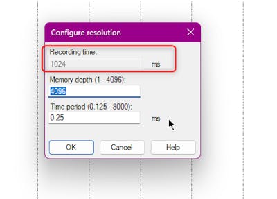

I want to do a FRF manually in the drive by generating the noise from drive integrated signal generator and During this process I want to capture the data for 100s with 0.25ms time period but the drive oscilloscope in the drive won't allow me to take this mesasurement, Please refer to the image below,
Could you please help me how I can perform this test? if its not possible from the drive could you please help me with other solutions?

This is simply not possible. Maximum are the mentioned 4096 points. Only way would be to use the control system exchanging the requested signals over the cyclic communication and then use methods on the control to get access to the signals.
