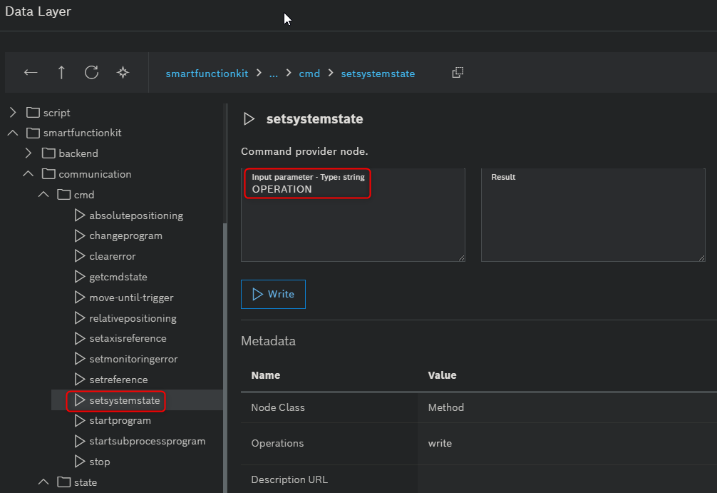

I wonder, what is the way to communicate SFKH with PLC was planned by developers of this product?
I try to communicate through DataLayer, but I can't even acknowledge error using smartfunctionkit/communication/cmd/clearerror command.
After I acknowledge emergency stop or STO signal, system asks for drives to be enables, if I enable drives via motion/axs/Axis_1/cmd/power command, system asks for kinematics to be enabled, if I enable it  in motion/kin/Robot/cmd/group-ena then I have no errors in HMI, but system doesn't move axis. When I execute any movement in the SFKH programm, it goes through without movement and with no error.
I use smart function kit app 2.1.1, PLC app ver 1.12.5, motion app 1.12.7.
Could someone help me? Thank you!
Best reply by fever_ferry
the clear-error command is just clearing all errors. To change the system state back in normal operation mode (drives, kinematic and motion = ready) you have to execute the setsystemstate cmd (attached in the picture):
path: smartfunctionkit/communication/cmd/setsystemstate
input as string: "OPERATION"
That should bring your system back to operation state.
