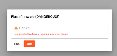

In order to continue my efforts to get Apache IoTDB deployed on CtrlX Core, I wanted to update my device (X3) to the latest available version (Which was 3.2.0). So I downloaded the x3 system image and started the update process including the saved setup archive ... now my device is not coming back up, but with the rescue system on the default IP complaining about the image:
What did I do wrong? And how can I get the device back into a running state?

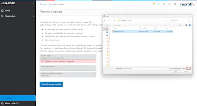

I think I might found what caused the issue on your side. In the "Firmware Update" Window you got to select a ".tar" file. So you got to unpack the zip you downloaded from the collaboration room and select the ".tar" you can find in the folder "rescue".ย
I just did that at my ctrlX CORE and the update was done successfully.ย
