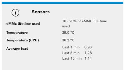

ctrlx-core does not use SDcard to run from but the more reliable MMC. You can see the wear level in the setings => information => resources menu
This is the screen of one of our cores we havily use for automatic updates. You can see it moved to the 10-20% range. Most are still in 0-10% after 2 years of operation so the problem is for sure small in daily usage.
