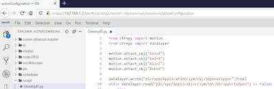

I am very intereasting in python with ctrlX. I have already installed the python app in my virtual controller.
some guys show me a example write by python,

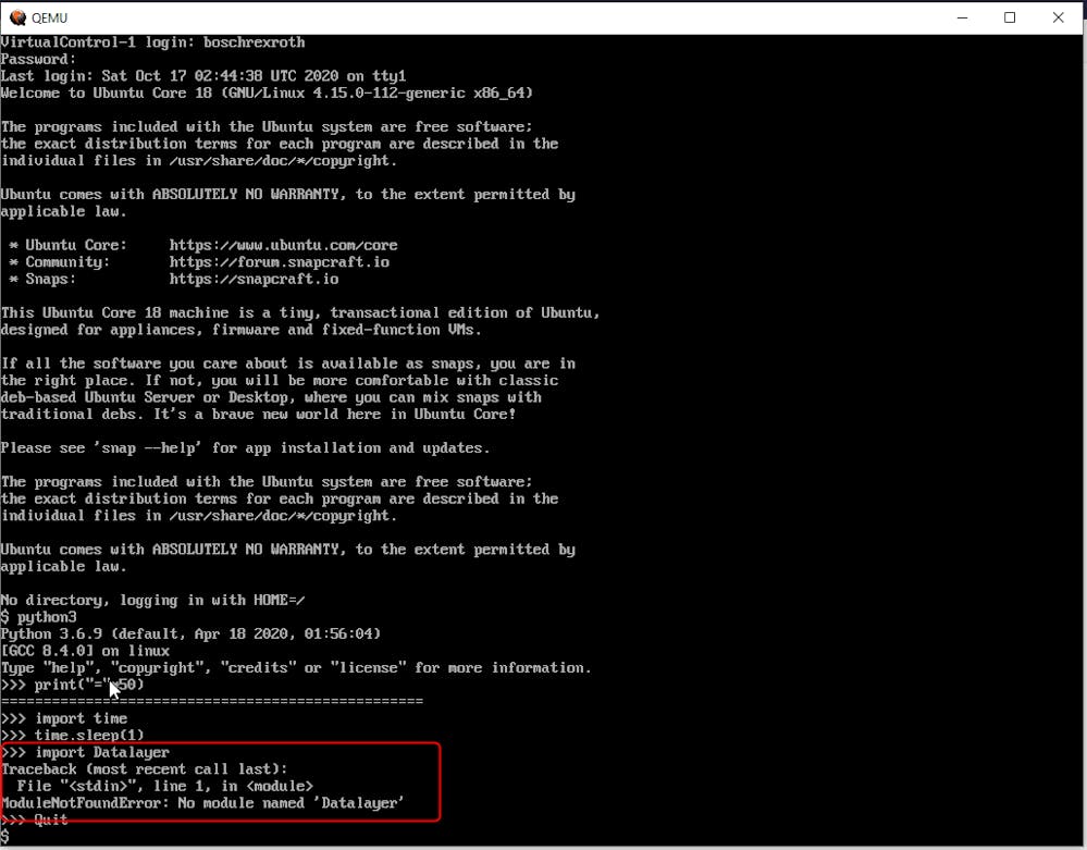

the first line is " import Datalayer"
when I try to import Datalayer, it will throw out "ModuleNotFoundError".
Is this module have already installed in the Virtal control?  Or should I do something special seeting?
Thank you very much!

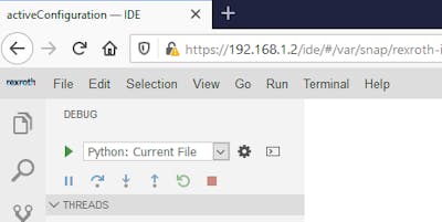

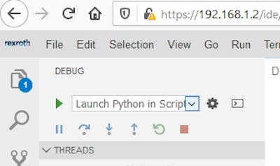

Further more there are two ways of running a script in the textual coding editor in the IDE app:
1) Run the script directly in the browser:
  • The signatures of the system functions are available and can be imported for programming purposes, like syntax highlighting and auto completion.
  • The interpreter integrated in the IDE app is used.
  • But the functions that should be called by the signatures are not available so this cannot run at the moment.
2) Run the script on the ctrlX CORE:
  • The signatures of the system functions are available and can be imported for programming purposes, like syntax highlighting and auto completion. Like above.
  • The interpreter of the python runtime on the ctrlX CORE is used.
  • Here the functions used in the code are part of and known by the python runtime in the system. So the import lines should be commented.
