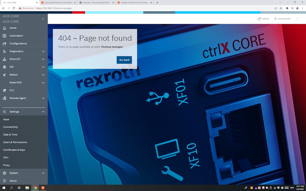

I am trying to access license manager on my new CtrlX to upload a license .bin file. I do not have the option under Settings->License and when I go to the URL for license manager, I have the below error. Any thoughts?

Hello Bala,Â
Which system version are you using? Please have a look at the version of your system apps (Settings -> Apps).Â
The licensing on the ctrlX CORE got enforced with V 1.12.Â
Hint: In the Collaboration Room (path: ctrlX_CORE_APPS/All-Apps-In-One-File/RM21.11 - V 1.12) you can find the SystemImage and a Guideline on how to perform the update in the Release Notes.
