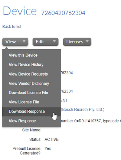

Maybe I am not generating the license file correctly. I log in to my Key User account, then navigate to the device. Click on "Generate Capabililty Response". Then do a View->Download Response to get the file.
Is that correct?

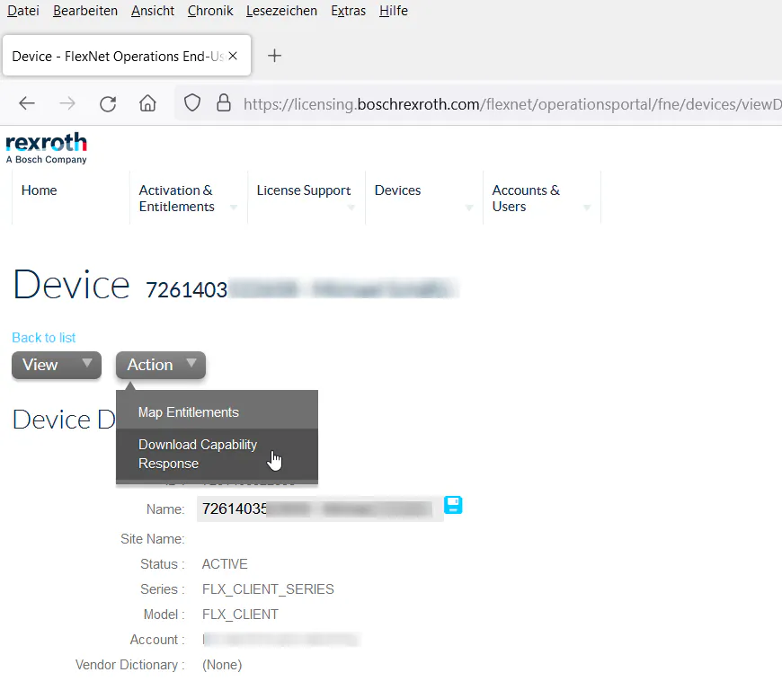

EDIT: The error code indicates that your license file is "out of order" so could you please check system time of the ctrlX CORE the license should be added to? As these files have a starting date there could be a problem.
The easiest way of getting your license file is click on "Action -> Download Capability response". Download will start right away.
ctrlX AUTOMATION licensing portal get license file
