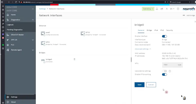

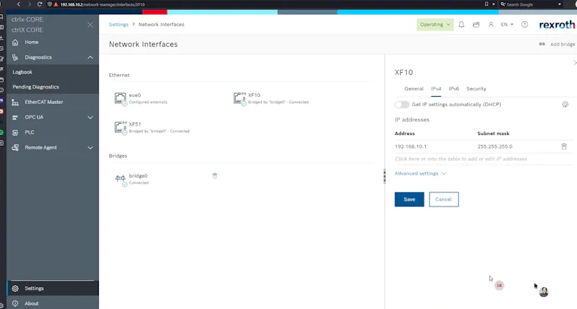

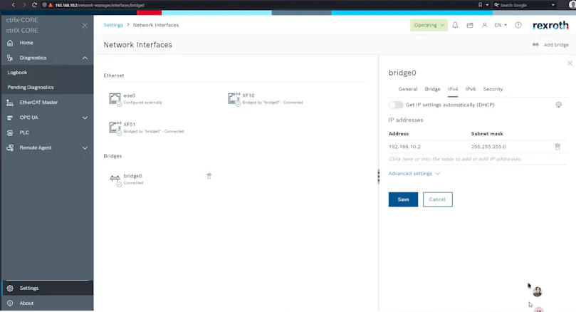

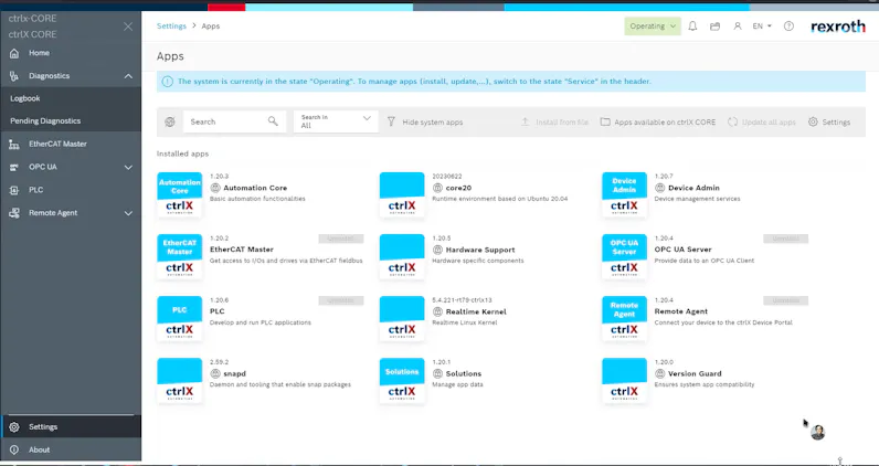

An application with 1.20 system apps has a network bridge setup so that the ctrlX CORE and an IPC connected to XF51 can both be reached with a single physical connection to XF10. Screenshots of this setup are shown below. In general this is working ok, but sometimes the communication stops working. It happened today such that neither the CORE or IPC would respond to a ping. The CORE web UI could still be reached via IPV6 and from there the CORE was rebooted. After reboot everything was working fine again. I have attached the system report/log files. Please let us know if there are any known issues or ideas to improve the robustness of this communication.
