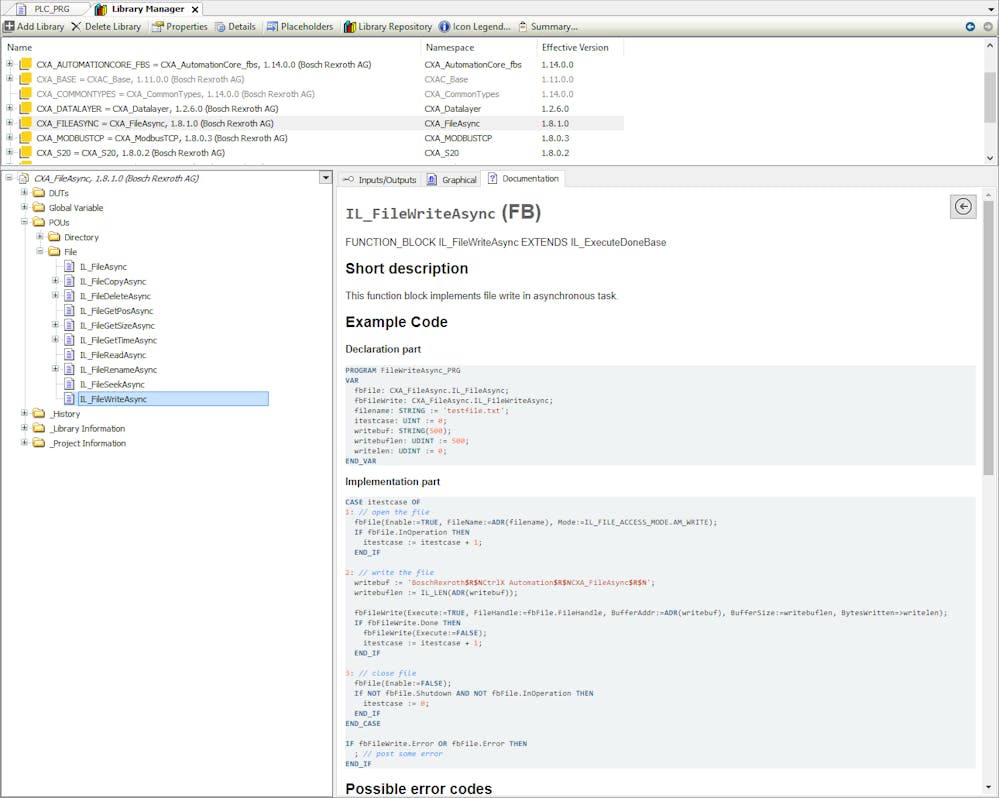

our customer is testing with our Drive based ctrlX Core to control their punching gun. Currently they are trying with PLC engineering to read and write the operation log into a csv file, which will be stored on a plugged sd-card in CF01 slot.
We found that there is PLC lib called CXA_FileAsync, is this the right lib to be used?
If there is simple how-to example, it will be really helpful.
