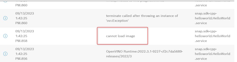

I am now copying an image file into a .snap zip, but I can't read the image, why is that?
What should I do to read this file?
thanks in advance!

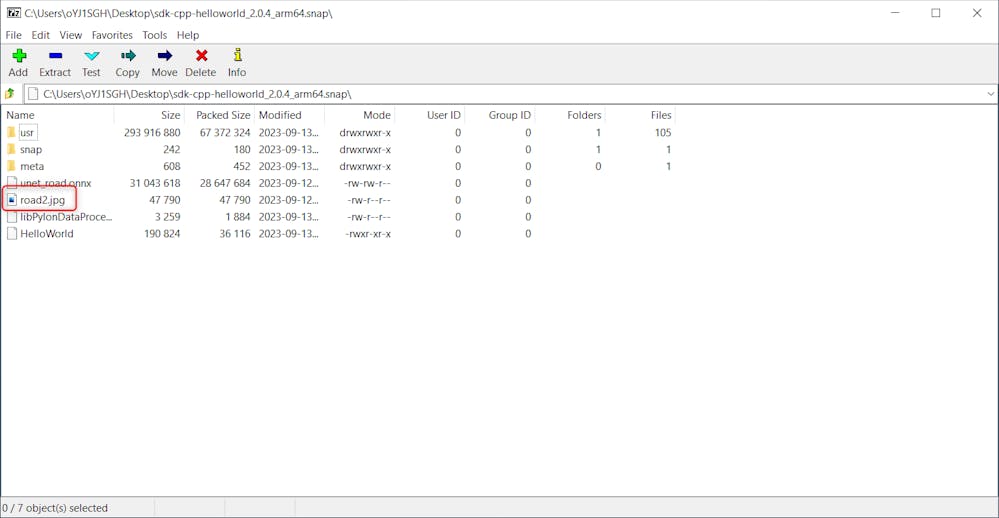

thanks in advance!

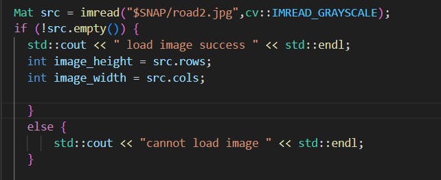

How do you pretend to be able to use it if you are writing it wrong?๐
See here: /ctrlx-automation-how-tos-qmglrz33/post/ai-and-data-analysis-the-jupyter-app-RELmTYA2Ic7zv0i
Basically you have to use the OS module to load correctly the env variables like $SNAP
